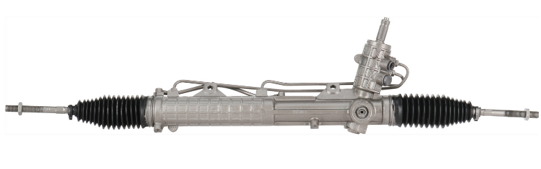

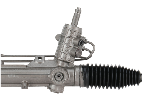

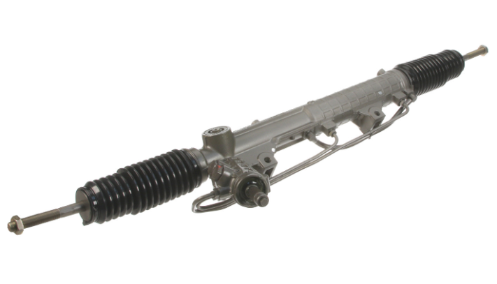

    Ive seen a lot of talk on this forum and others about avoiding Maval steering racks, and typically I would search for a used steering rack and call it good, but I cant seem to find any. Most of those discussions are pre-covid, which means that odds are they havent gotten better in quality, but its always possible. Looking to do a Z3 steering rack swap on my 87 325e, and ETK shows for a z3 the part number is 32 13 1 096 280, which WorldPac and IMC both sell as the Maval 9816M. Seeing as im unable to find a used rack, and the BMW one is 1500, im considering maval as my WP rep says he can give it to me for 230$. He also said that theyve sold that particular rack 180 times, with a return/warranty rate of less than 3.5%. Should I take the risk or keep looking for a used one?​

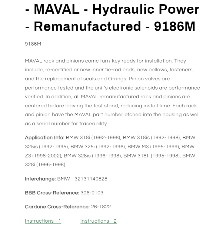

    Also worth noting that other people seem to have input on the Maval 9302M, not sure if this is for an e36 rack or otherwise, or if maybe the BMW/Maval part number has changed, but worth mentioning

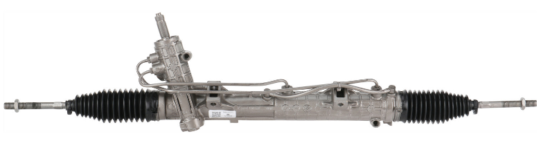

            [QUOTE=82eye;n10124283]it won't be a z3 rack. it's a replacement but the lock to lock won't match. they build a generic.
            Yeah, sure enough its a generic rack for the e36 chassis, not just the Z3. Super disappointing, considering its the same price as a used Z3 rack on ebay but it comes with tie rod inners too. Oh well, used rack it is. Click image for larger version
