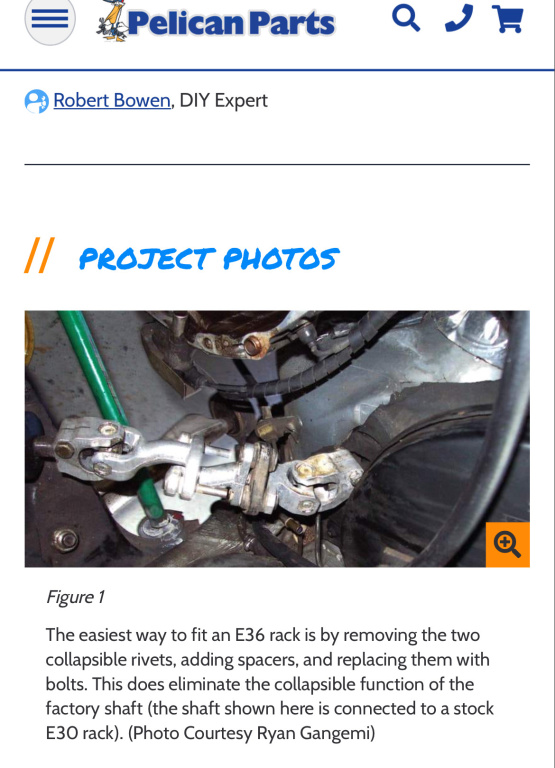

    In short, I've noticed that for non-airbag E30s you have to modify the steering joint in a way that removes the collapsibility that keeps it from impaling you in a head-on impact. Vorshlag makes a really neat collapsible u-joint column that eliminates the slop, but it's over $500 which is a little steep. Is there a way to swap racks but not lose the bit of safety margin a collapsible column gives you for not-$500? Obviously step 1 is "don't crash", but you never know when some dickhead drunk driver will slide out of his lane and plow into you. Given my car has no airbag I'm already not super confident in safety but I don't see a reason to make it worse, you know?

      Ahh, I was under the impression grinding out the rivets and replacing them with spacers and bolts on non airbag cars removed the collapsing feature as per the Pelican rack article. How did you modify the donut then?

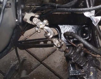

            Not the pic I was looking for, but it'll do.
            Not sure you'd get away with PE or delrin because it's pretty thin and I think you'd need the strength.
            I ground the rivet bucks/removed the steering guibo, then traced it onto a piece of flat bar and holesawed the basic shape, then enlarged the center + drilled out the 4 bolt holes.
            I'm pretty sure there's a centering pin attached to one side of the joint that I needed to shorten, then test fit it and grind wherever the u-joints bind.
            lock nuts and some loctite for muh safety.
            It doesn't spin fast so it's not picky about if the holes are perfect.
