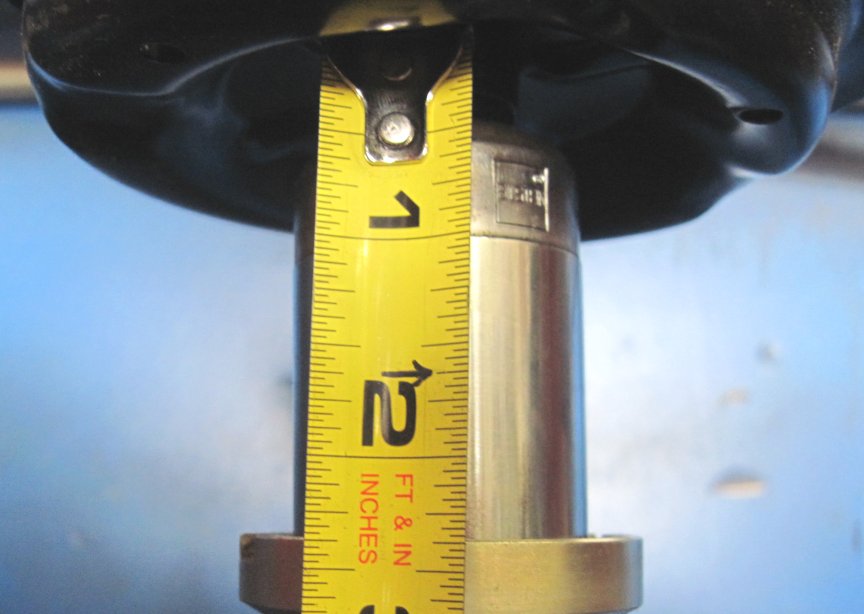

So I have taken a picture, and I will show you how to do the math yourself so you can understand the emphasis on "always". It is not exaggerated or misleading, it is just mathematics.
OK. In this pic here is a Bilstein sport front strut, #P36-0335. I have put the strut into the famous GC press of destruction and compressed the strut until it is now sitting against the Bilstein internal bumpstop.
I have set a measuring tape against it. I have tried to make it so you can copy this measurement on your own car.
If you look at the pic, the Bilstein strut is sitting on its bumpstop with 2 3/8 inches (61mm) of strut showing. This is why this subject can be so misleading. It LOOKS like you have a lot of travel left, but you actually don't.
Now, go measure your car exactly the same way. Anything you have OVER 2 3/8 inches is how much suspension travel you have left before your Bilstein Sport is hitting its bumpstop. Let's just say you measure your strut (just like I have shown in the picture) and you show a number of 3 1/4. This means you have 7/8 of an inch of strut travel, and every time you hit a bump higher than 7/8, or lean into a turn more than 7/8, you will be on your bumpstop. (3 1/4 minus 2 3/8 equals 7/8 inch)

Now, we come all the way around to the whole deal about shortened housings. If I took the same exact picture, but with a shortened Bilstein in a GC shortened housing, then the number would be 3 3/8 for example. Now you can imagine that is the same situation as before, with the car hitting a bump over 7/8, that you will NOT be hitting the bumpstop and will not be affecting the spring rate.
I hope this makes sense, and I hope you will actually go out to your car with a measuring tape and see what I mean. Do not jack the car up, just turn the wheel and slide the tape up until it stops.
If I were to shorten my Bilstein Sports to work correctly with my GC setup how much would you suggest to have them shortened?
According to your example it would be 1" shorter than stock. Is this enough?
And would I just ask Bilstein to revalve them to match the Eibach 440lb linear spring?Last edited by MC Hammered; 09-17-2010, 12:47 PM.

You cannot shorten Bilsteins, you need to buy new shorter ones.Thanks for the description Jay as it clears up a couple of misconceptions I had in my head.
Clarification: Actually you could shorten them, but it would cost more than buying new shorter ones and having them revalved.
The yellow part of the Bilstein, the chrome part, and the rod all would need to be changed to shorter pieces. So all three major parts would need to bought new, plus labor.

Since I have the shocks already I was considering the option of sending them back to Bilstein to have them shortened and revalved, that is why I was curious about the amount to shorten them.You cannot shorten Bilsteins, you need to buy new shorter ones.
