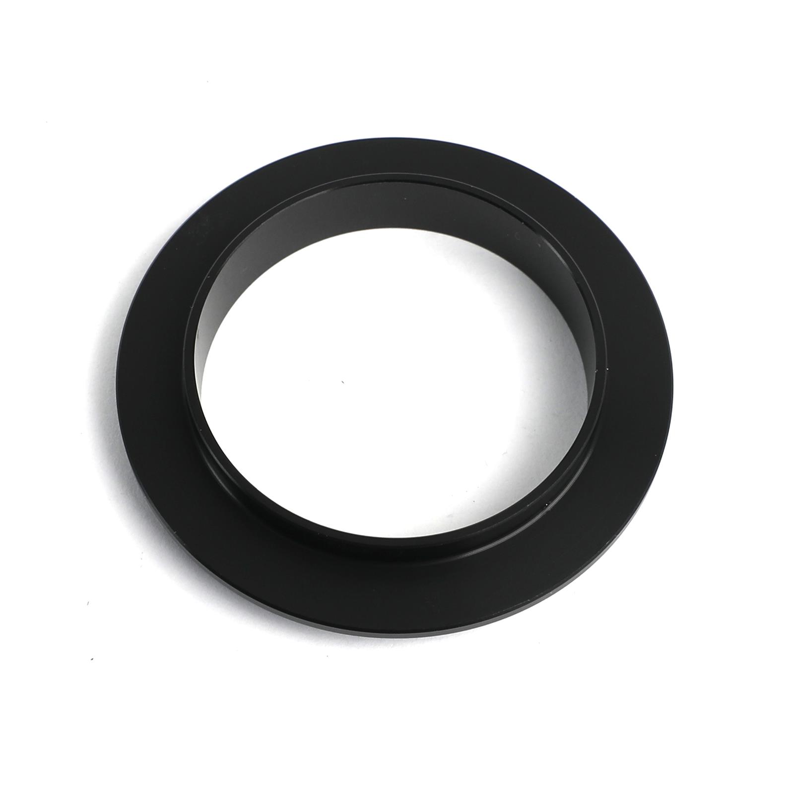

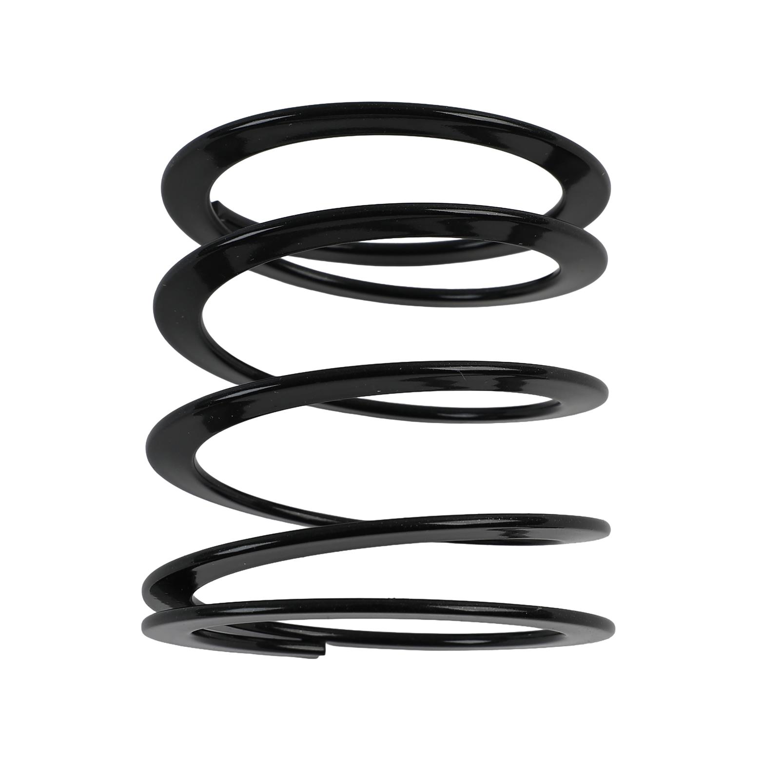

                  Here is the helper spring to match.
                  And here is the coupler to get the two to line up.

                      You might. Before you put the spring in, take the old springs out and measure the wheel/fender gap. Install the spring and measure again. The difference will be your compressed suspension travel.
