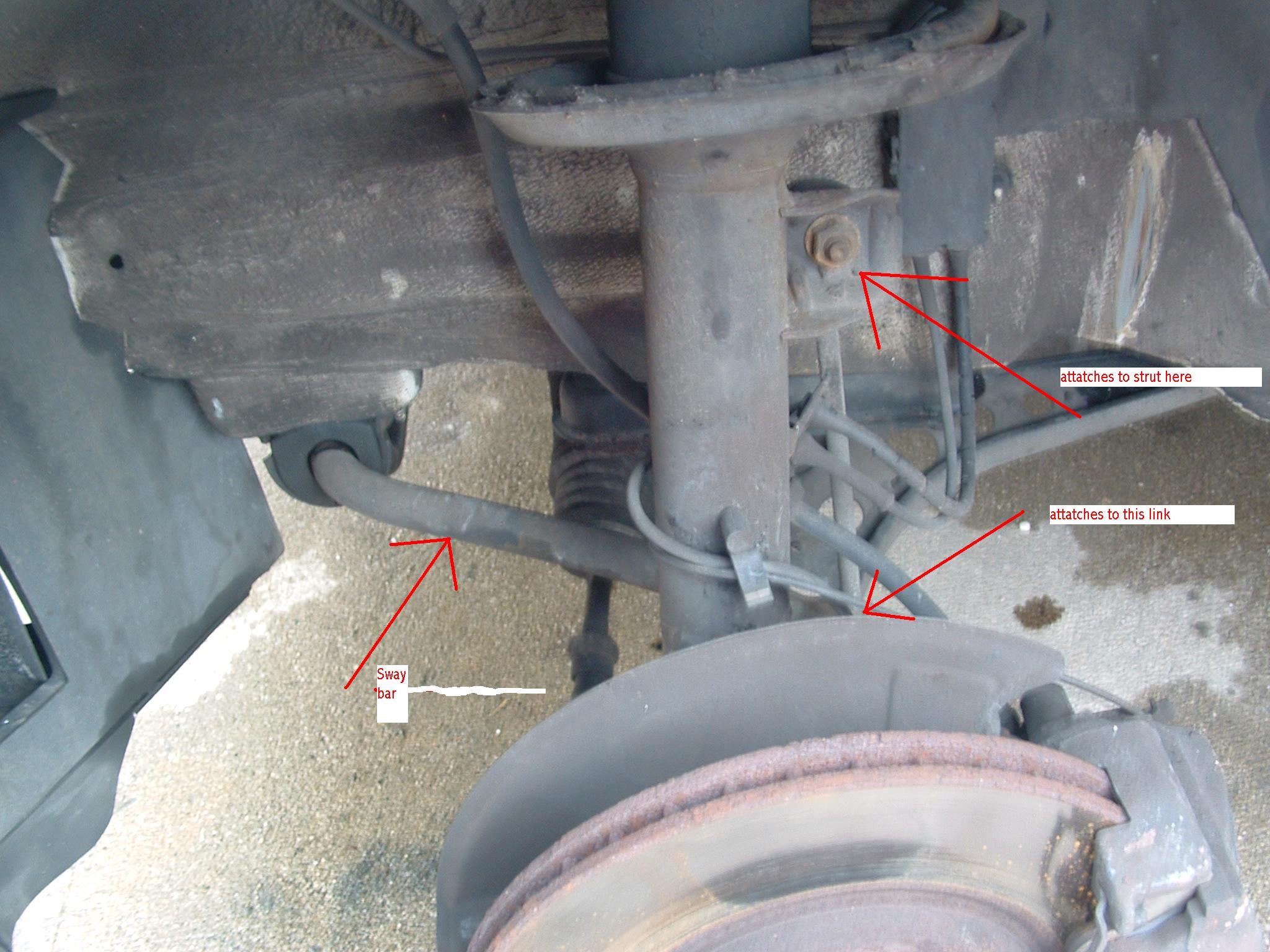

          I'm thinking something like this. I believe the early e36 were setup this way.

            I got the idea from all the jeep guys I'm around. A lot of them will go to a sway bar like this for long travel setups. Obviously not what we need it for, but the concept of being able to place it where you want is appealing.

              I can't see why not. later cars have the "extended" frame rails that you could mount it to. you can get polyurethane swaybar bushings that come with their own brackets, you could put some caged nuts in the frame and just bolt it up.
              lots of really cheap used BMW swaybars that would fit too.
              yes, the ix is up front.

                I was thinking maybe get a vert sway, get bushings like you stated and flip it around, the run the rods to the struts for my 5-lug setup.
