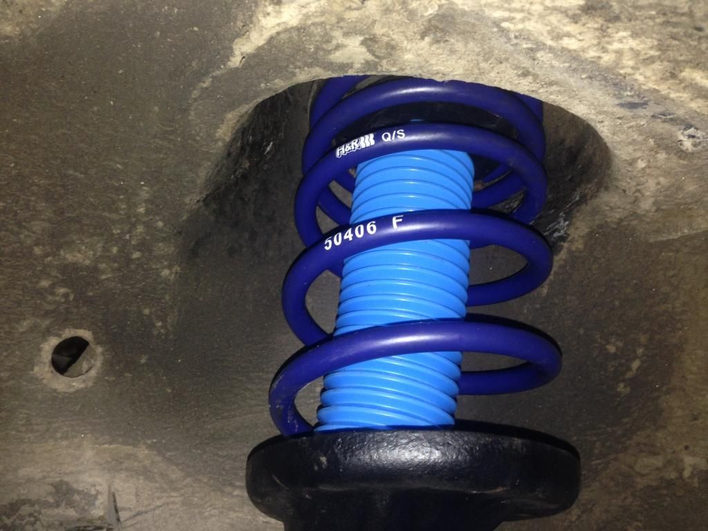

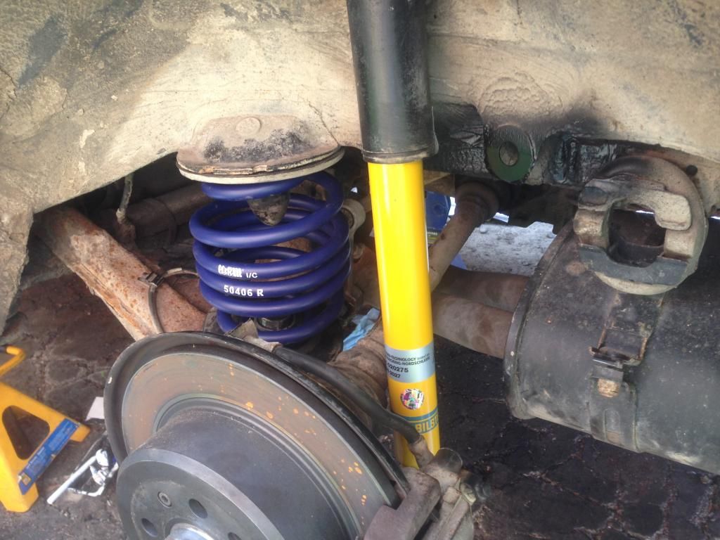

                            I checked the number on my springs before I installed, and they all have "50406" on them.

                              those look like the OE sport springs. not the HR sports. HR sports are dark grey metallic.
                              yours say I/C. normal ones say N/A
                                I have contacted Turner Motorsport who I purchased them from, and asked them to clairify if these are the regular or OE Sport springs.
                                The product description page lists the package (springs and dampers) I bought as having H&R Sport springs.
