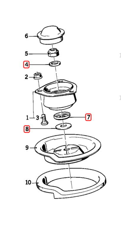

    I'm confident I didn't misplace any hardware. The Koni Orange struts are a larger diameter 22mm nut vs 19mm which seems to be the reason the one washer below the strut nut didn't fit
    Make extra sure you got all 3x washer back in place, especially washer number 8. Otherwise you more then likely have a faulty top mount like your thinking.
