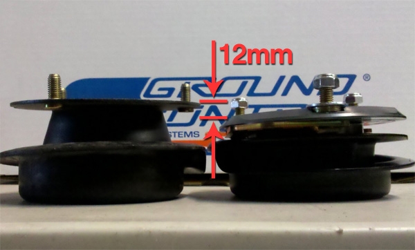

        2Man, had no complaints with the set up at all. Eventually I did pick up a set of GC camber plates though. Really the only reason I picked them up was for the simple reason that the camber plates lower your car an additional 12mm in comparison to the normal top mounts (well plus you can adjust the camber to get a little less tire wear).

          But with Camber plates versus the regular strut mounts aren’t you introduced a lot more noise and road feel into the cabin? Makes sense to ā€œtighten it upā€ for a race at but I’m aiming for a good street setup.... yes I could’ve done a spring / shock combo but my GC/ Koni coilover setup is almost the same price so why not? Plus I can fine tune the rates to perfectly suit me

                Nope, no noticeable difference in noise/ anything. If your looking to save a few bucks though I'd say just skip the camber plates and instead put some new top mounts in.
                Also IMO you might as well do the GC kit route over a spring/ shock set up like you said. GC is a little more money of course but it's nice you'll have the adjustment, plus you have multiple options for spring rates.
