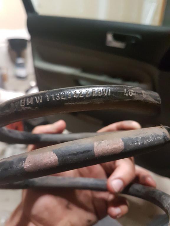

    My E30 came with the M-tech suspension option from the factory; Bilstein HD's from the factory (yellow mono tube, BMW stamped) and associated m-tech springs.
    I had bought H&R OE sport springs and was surprised when I went to swap them that the M-tech springs were quite a bit thicker. Felt a bit weird swapping beefier springs for thinner springs
    In the near future I plan to swap back to the M-tech springs as I found the OE sports are softer and I preferred the linear feel of the original springs versus the progressive nature of the H&R's.
    That aside, I have been trying to do research on the M-tech springs, as they don't seem to come up in the ETK or places like real oem.
    The front springs are stamped "BMW 11327422RBW 46 C" and marked with 4 hot pink dots.
    The rears are marked 1132317 and are marked with 2 red dots.
    Anyone have a way to look these part numbers up?

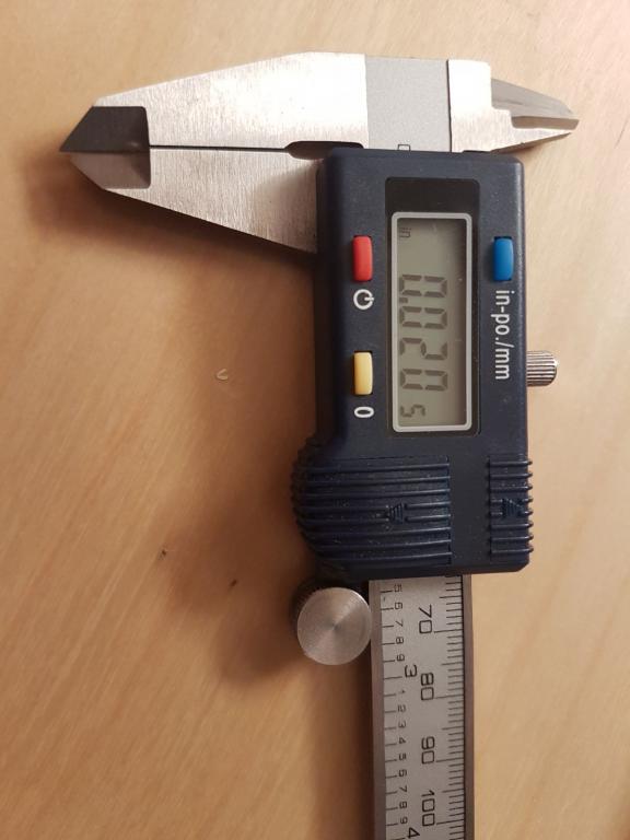

          Originally posted by e30sh
          That's a nice calculator. Mic your wire diameters and see what you have. Wire diameter does make a big difference.
          If you just want a to see what going from 6 to 7 coils does, guesstimate and leave all the numbers the same except # of coils.
          To make up for the difference in one coil, the spring would need to be ~0.02" thicker.
          I have attached how small that really is.

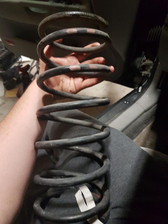

                          I just bought new 31331130054 and 33539061134 springs.
                          Front thickness is 13mm.
                          Fronts are true 6 coil:
                          Your resource to do-it-yourself and interesting bmw and e30 stuff: www.rtsauto.com
                          Your resource to tools and tips: www.rtstools.com
                          • noid
                            • 1536
                            HR OE sports, Mtech, S704 M sport suspension springs.
