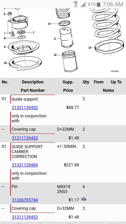

    I replaced both my front strut inserts and installed both of the struts back on the car. When I took my car to get aligned one side is in spec of -1 something and the other side was -2 something. Not sure if why this is. Im using lower springs and e30 m3 control arm bushing but I dont think that caused such a change in camber on one side. Any help. thanks

    Did you use new strut mounts? They compress over time. There's also a stock mount available with more offset. Did you forget to install a washer? Spring hats go bad too.
    Maybe look into installing adjustable mounts.
          Yes I got new strut mounts, and pads, installed everything per the pretty crappy instructions. Did not know they had different stock mounts with more offset. I might have to go with adjustable spring camber plates.
