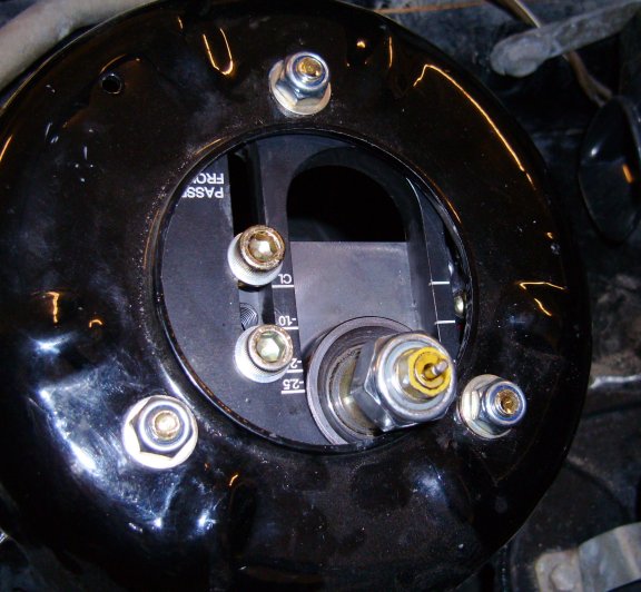

                          Hey, its Jay from GC joining the thread. Welcome.
                          Just wanted to post a picture of our shop E30 at last weekend's SCCA Divisional event at Texas Motor Speedway. We played with camber settings to clear up some understeer on Day 1 we were experiencing. Went from -3.8° to -4.3° (which was the max for this car) up front and the both drivers dropped 1 second on a 60 second course. This alignment was achieved using our off-the-shelf Vorshlag E30 plates and AST 4100 front struts with 60mm springs. This picture is with the car fully loaded in a corner data logging 1.15g lateral on shaved 140 treadwear 205mm Bridgestone RE01Rs (this class is limited to 140 treadwear or higher, with 225mm max width).
                          In our experience the springs are the biggest limiting factor for camber - if you have OEM springs they will contact the strut tower long before the top of the strut shaft runs into the strut tower opening up top. With coilovers using 2.5" or 60mm springs, this isn't a concern, so the more travel you can get up top the better. Lower ride heights also get more negative camber at all settings. Our car is fairly low, 12.3" from center of wheel to fender lip, using 1" shortened strut housings and a 6" long coilover spring. So with these coilovers we are seeing a maximum -4.3° of camber and +9° caster using our plates.
                          Can another plate design possibly get more than that? Sure, its possible. Do you need more than that much camber? I don't know, it's debatable, but our testing shows the best cornering power between -3 to -4° in most BMWs. One more thnig, with our shorter single-row sealed radial bearing perches you get 5mm less stack-up height than with our standard double row bearings. This works for race set-ups that are using coilovers (like our car has), but is not made for OEM perches (which themselves are pretty tall).
                            yeah, sucks actually, I really have a full plate besides this.
                            Cheers,
                            You cannot move the strut 0.920 *edit*(-0.920 is the range of travel, 0.730 is distance to the center) over from the center of the strut tower, on an e30 with unbent struts, and get 4.3.
                            Notwithstanding, lots of people run more than 4.3 with great success, especially road racing, but also some parking lot stuff too.
                            Mathematical proof in the next post.
                            Jay Morris from GC slept at a Holiday Inn

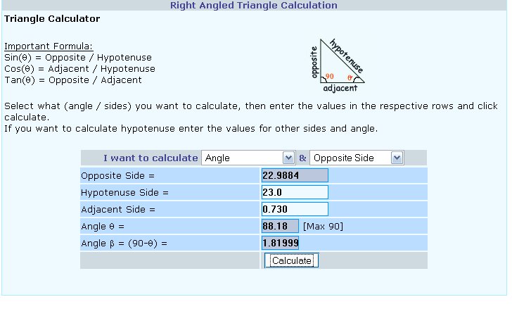

                                For those of you who don't want to go measure, or those of you who do:
                                The length from the center of the lower ball joint to the camber plate pivot is 23.0 inches (on an e30 with 12" CL to fender). This is essentially how long the front strut is. Lets make this the hypotenuse of a right triangle. The short side of the triangle is 0.730 from center of hole to max inboard, on the camber plate referenced above.
                                Here is the link to an online calculator:
                                Therefore, an e30 with 4.3 degrees at max negative, will be
                                Use the numbers I have provided, or measure your own.
                                Long side, hypotenuse, the length of the strut, is 23 on my 1987 325is. The movement of the camber plate is 0.730, which is the "short side". The online calculator makes your HP35 obsolete as it figures out the sine for you.
                                My answer is 1.8199 degrees (rounded to 1.8-degrees). This is how many degrees of camber, a 23 inch long strut will gain (or lose) when moved 0.730 inches. You can try your own measurements.
                                Therefore, when sliding the strut back toward positive to the center of the hole, what should the camber be?
                                -4.3, sliding to the center +1.8 degrees means that in the center of the strut tower the camber will be -2.5.
                                Lots of guys here have their e30 lowered to 12 inches from the center of the Roundel to the fender lip, but dont have camber plates. Are they all running around with -2.5 degrees negative on their daily commute? I don't think so. Otherwise there would be a clamor for camber plates that TOOK AWAY all that negative camber.
