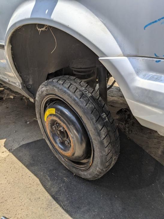

                      Results:
Name:	SLntqvAzIYlL-qnXQ0bV5f046CIAbxGZNjqmNKNdnqvQZFIq26uNAJd3SB_C0NJiqagfyuM8kd4HAhCpIdUgDmhw5R1VpSk9GV6QGtL2XTeBBBHGgKOgaPfNyCINLEN7VvTc3-ldOB7sqKIHmHUQjG9lPOm6Ldq6l8ZuV1SUBL4v-6vqQjke6AWVaYXQJkApu23bR_73fXgb_BdMiWIJXlMAoI6D8QCOFAYPAt12Mh23iBHxyDIoJw_9H3kgZ8r
                      I mounted it on the junkyard car. So obviously it's not sitting at ride height.
                      It fits the rear. It does not fit the front, as it hits the brake caliper.
                      I'm gonna go ahead and assume only an idiot would put it on backwards. Please confirm.
                      So because it technically fits, I bought it. $20.

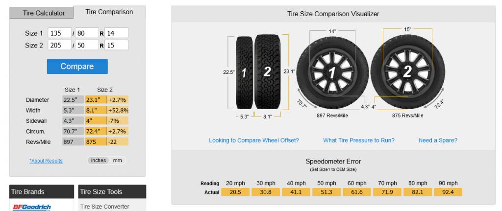

                      I looked at what tires are available, in what sizes. This is the basically the only option I found:
                      This size equates to a 2.7% difference, according to this chart:
                      Would you consider this to be too great of a difference for the differential to handle? For open diffs, no, but what about the LSD's? Personally I have a 3.15 Torsen, and I think the gears would allow a slip like this. But I have no actual idea. I want to 2.93 clutch type later, which I assume would certainly allow a little slip.
                      Does anyone know details, if this is a good call?
                      I'm preparing for a road trip soon, so this is a $140+ decision I'd like to make soon.
                      I will also buy a tire inflator to keep in the car. I like the idea of a spare as a "last resort".
                      Thanks guys!

                        The wheel is on correctly, not sure if you can find new spare tires alone, and at under 3% any diff should be okay for a short time, but I base that on conjecture alone.

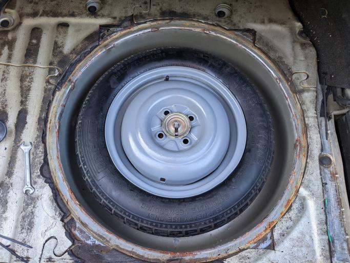

                              Update: Pictures!
