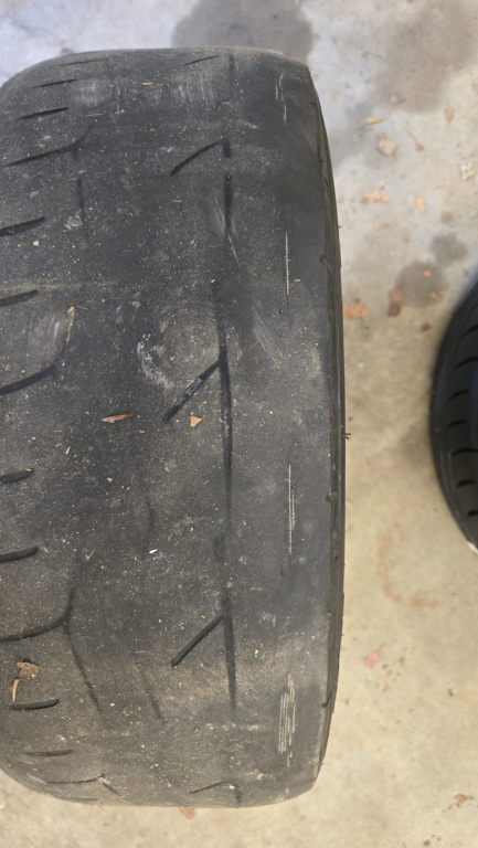

    What causes tire wear like this?
    I have a nasty shake at highway speeds. Noticeable at 65, threatening to shake the car apart at 85. Nothing seems loose if I jack up the car and try to wiggle the wheel back and forth. Front right has a bend in the rim, but both tires are worn like this. The tire on the bent rim is worn more than the other side. I know a bent rim can cause a vibration, and I'll be fixing that, and the tires being worn like this I'm sure is contributing also, but how did they get this way to begin with? Sort of a butterfly effect from the bent rim, or something loose in the steering that isn't obvious from wiggling the wheel? Bad alignment? I don't think I've seen a tire worn this way before.

                I think I may have the explanation for the uneven wear though. I noticed this a few days ago. I think the scalloped effect is simply due to how the tire is made. It's on both sides, and it has a specific pattern that follows the pattern of the tread. The spots where it's worn down to the cords are pretty much perfectly between the diagonal grooves in the tire. If someone has an alternate explanation, I'm open to ideas.

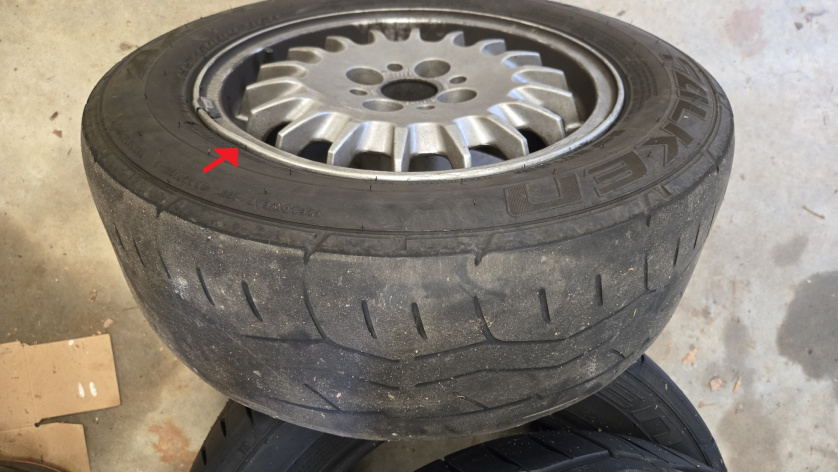

                The second thing I noticed is that the one tire is bald all the way around except in one area, that happens to be right after the bend in the rim (marked with red arrow), as if the tire is bouncing in that spot, and therefore not wearing as much in that area. Again, alternate theories welcome.
