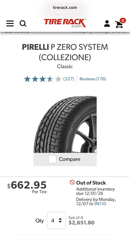

    I've had the same predicament and honestly, there isn't much. I have, however, discovered that if you don't mind a chunkier, meatier look (which I prefer over rubber bands) there's plenty of posts that talk about running 225/50/15 without rubbing or the like (example here). When I move up to 15"s I intend to do the same or similar, I've seen talk of 225/60/15 and 225/45/15, as well as similar. As far as classic look there's some Pirellis meant for like Ferraris and Porsches that are 1.5-2 grand a set (Pirelli Cinturato P7 (Collezione), Pirelli P Zero System (Collezione) Asymmetrico) but for 14"s Michelin offers the MXV-3 now which is period-looking with modern compounds. Those are also a bit pricey but not as bad as the Pirellis. They don't offer it in 15" yet unfortunately, as far as I'm aware though I'd jump on those if they did. Discount Tire still offers Altimax RT45s in 215/60/15 and similar and those are relatively classic looking and a good all-season if you're not set on summer performance. I think Maxxis' summer isn't half-bad either? They're a well-respected bike tire manufacturer. No hands-on with those myself though.

        225 seems like a good option on 7” wide wheel, but that Pirelli also seems to be unobtanium (and pricy). Hoping to stick as close to 24” diameter as possible.

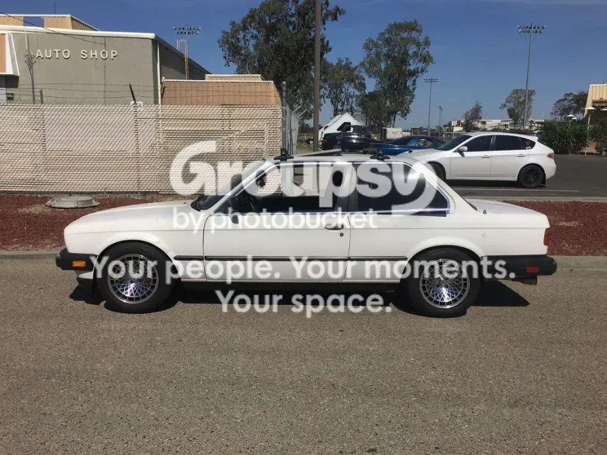

                  Those always look too small in the wheelwell for me, even dropped.
                  I saw this pic somewhere on here a while back and saved it, it's apparently 205/60/15x8 dropped with no rubbing (forgive the shitass watermark):

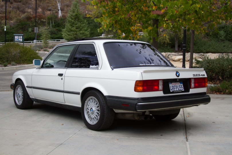

                    I ran 225/50/15 on 15x7 and it was much better than the 205/55/15 they replaced. I'd say that's the best bet these days given availability.

                      It looks good, too. I linked the original upload in my first reply but just for posterity's sake, 225/50/15 ET25:
