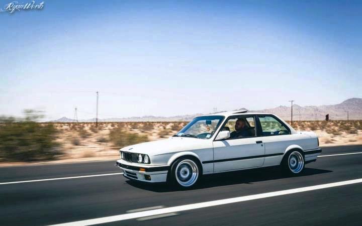

 Mine's Diamond Schwartz but it looks just like this pic above. I still think that looks pretty damn good.Comment
 Why 205? That will look quite odd...
 Why are the offsets 'gay'? 16x8 et20 is absolutely perfect.
 Exactly...
 16x8 et20 with 225.45.16 is literally perfect and it's the exact same rolling diameter as stock. I really want a set of these... My old E30 had this spec wheel/tire and looks perfect.

 This is my flush fitment setup that I use on my project 318is drift car. I think wheel fitment is important to any car. I like a car to perform as well as it looks personally. My car has zero rubbing with the fenders rolled flat. I am running 15x10 +15 rear and 15x9 +10 front. I've run several different sizes of tires all with some stretch, but I didn't run into any issues with clearance on that wheel size and offset so long as the tire didn't exceed the rim width. There is still some more room to play around with a little more offset and such (rear could prob use an extra 5-10mm spacing), but I found this to be a pretty good balance at least for now. Also not many people venture into the 10" range on E30's so I feel pretty good about it without looking like I am trying too hard. Also keep in mind you will typically sink in about 8-10mm's more in the rear on E30's if you run the same wheel width and offset front and rear. So you would either want to run staggered widths or have a lower offset in the rear to match the fitment front to back.

 ^ so with the borbets they come 16x9 and 16x8. If I ran those with a 20 offset I could likely get away with no rolling but a 15 offset would give the more wide body look but it would likely need the rolling right? I like the rolled fender look I just want to be careful that my car doesn't turn into a project car. Like I said above I don't need it to be the best of the best. For me I like to be super clean and have ease of ownership. I've had project cars before and learned a lot. I can spin a wrench if I need to but I'm the type now who wants to tighten it and forget it.Comment
 ^ I roll the fenders on all my cars. It gives you way more options whether you track your car or park hard. I feel it is a must honestly for anyone that is serious about modding a car. If you are even considering any kind of aggressive fitting wheels then you want to roll your fenders. Since you are in Socal you could find a local to just do it for you for pretty cheap.
 You are not going to get flush with the fenders without rolling... especially in the rear.Comment
