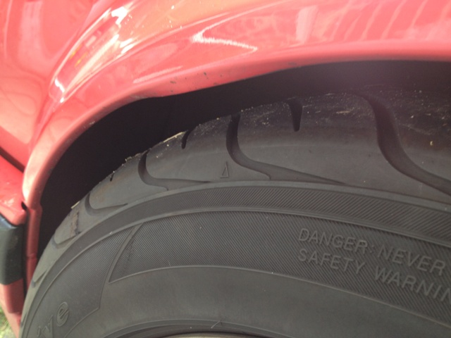

          I have this problem with euroweaves on 205/55r15 yoko s.drive sitting on ST lowered springs and offset CAB. I was turning left entering a driverway and heard it rubbed. I may have to go back to stock CAB. The s.drive is a very good tire compared to the all season michelin.

            or roll your fender lips
