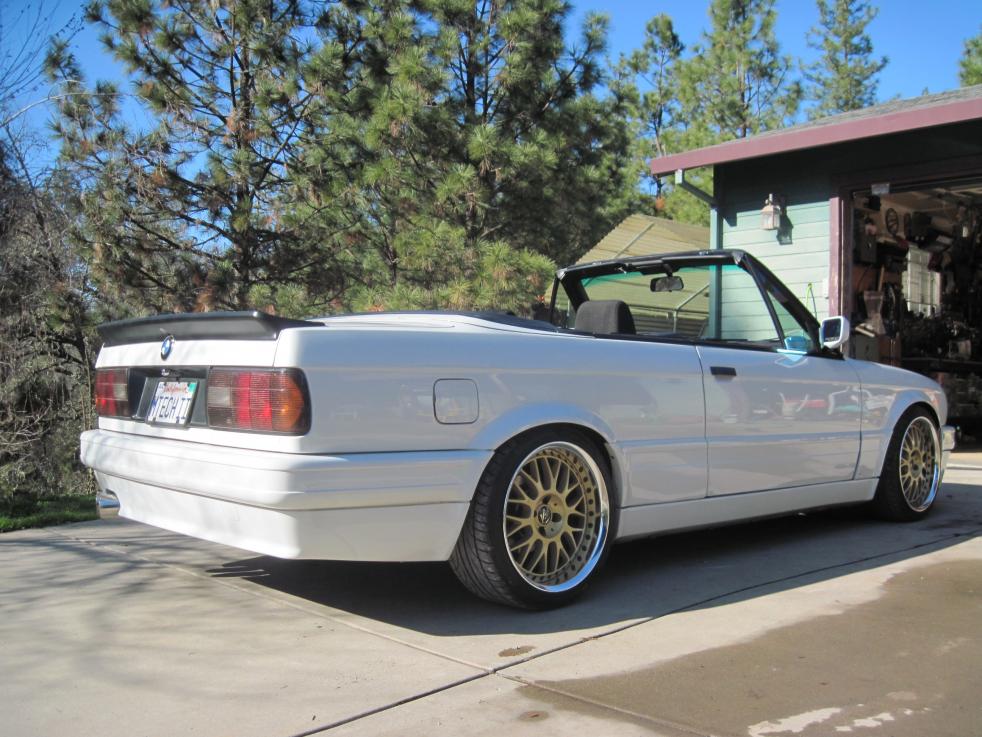

        245/35 17
        9" rear 20 offset
        Suspension tips here...
        http://www.r3vlimited.com/board/album.php?albumid=757

            Thanks!
            265s rub. It's a tight fit.
            The sad part is I bought the last pair of 245/35 17s in the US last year, and noone makes a street tire in the size any more.:(
            I have no idea what I'm going to do next time...
