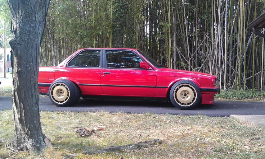

      • lbreevesii
        • Aug 2009
        • 412
        #5673
        Bah. Thanks, tire choices are just so much better in 235/45!
        I don't always wreck cars, but when I do I wreck them into trees.
