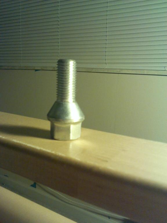

                  I'm glad I found a place to ask my stupid ass question. I have bottlecaps right now, but I'm looking to buy some BBS's. Went and looked at them today, they fit my car, but the stock lugs I have were too short. If I just buy some longer studs will the rims go on my car with no problems? What exactly are these "lugs" called. Searching for "longer stud" always brings up spacers. Where can I buy what I need?
                  This is the part I was talking about in case I am confused on what it is called.
                    check here:
