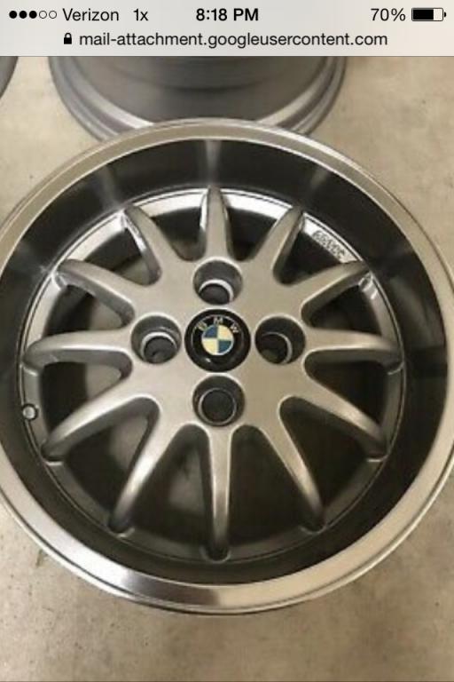

15x7.5 et0 had 205/55s on it, partial roll, lips are at like a 45° angle. took tiny slivers from the sidewall but wore the tread out before getting sketchy. If I roll the rest of the way would 205/65s fit?Jah bless! :pimp:Comment
