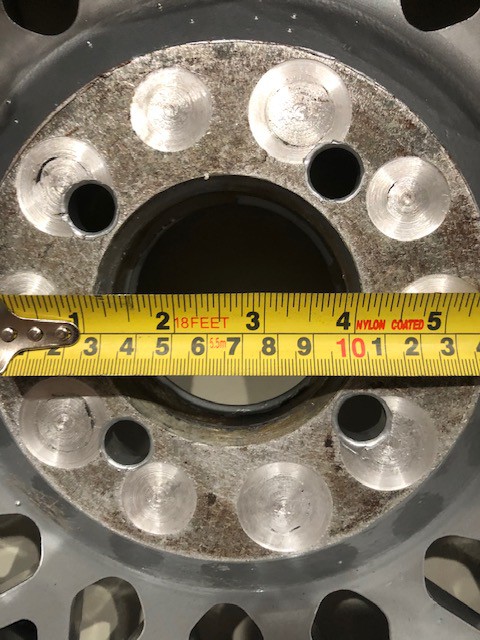

      Hi Everyone,
      This is my first post in in this "department"...so not sure if I should be posting on this thread or if I should be making a new one? Anyway, I really need some help with figuring out what tires and spacers I need for my new wheels on my E30. I bought and re-drilled (4x100) some e34 style 5's (15x7). Today, I jacked up my car to see how "bad" the rubbing would be to interior parts of the suspension. It does look like i'm going to need some spacers. However, I would like to know which specific ones because the hub ring on the new style 5's is way bigger than the stock hub ring on my e30 (and I believe bigger than most e30 aftermarket spacers).
      What spacers should I get? What size (15mm?) What tires should I purchase? (i'm thinking 205/55/15 but i think these might be too wide and rub). Would 195/55/15 be better?
      Thank you all so much for the help! I've uploaded a couple of pics for reference...

          Originally posted by e30mitch
          Hi Everyone,
          Click image for larger version Name:	IMG_9973 (1).jpg Views:	0 Size:	29.9 KB ID:	9915158 Click image for larger version Name:	0FBDEEDA-7282-4FAE-A89E-0D7B328C136A (2).JPG Views:	0 Size:	23.9 KB ID:	9915159
          If they are really from an E34 the hub size is 72.5mm. You can get 72.5mm to 57.1mm hub centric ring adapters. Then just buy regular E30 spacers in any size you want, 5, 10, 15mm etc. I dont know the offset of the E34 wheels you would need that to give you an idea on spacer size.
