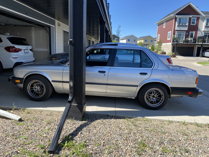

                        I need something a little more all-season than the Falken Azenis tires I have currently, and considering Kansei Tandems from Tire Rack. They suggest a 15x7 et25. I don't see anything about spacers (or longer lugs, for that matter), and wondering if I'll need to do that.
                        Most recent pic of the car:
                        It's on a set of H&R coilovers if that makes a difference...

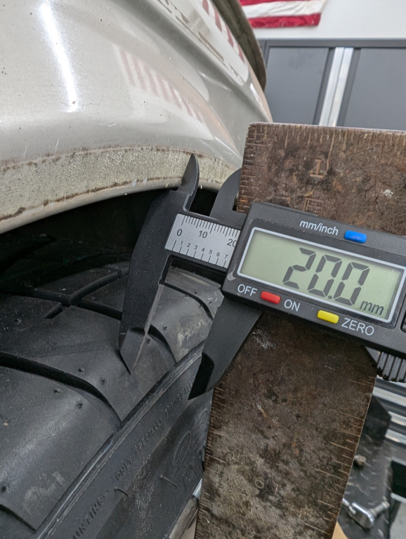

                                I have a set of 4 SSR Formula Mesh 16 x 9 ET +26 with 225/45/16 Toyo R1R mounted on my 1987 325is with H&R Sport Springs (which I believe lowers around 1.25") and Bilstein B8 struts. I was hoping to go as wide as possible (she's M54 powered and needs bigger brakes and a bigger contact patch) without too much fender manipulation and avoid a staggered setup. After spending hours in this thread and PM'ing a few folks with similar setups to what I was going for, I thought I should be able to pull that off. However, now that I've got everything mounted up, the front wheels are poking out further than I had hoped (about 20mm past stock unmolested fenders). The pictures below are with a front 15mm wheel spacer (bringing me to ET + 11). I'm afraid going with any thinner wheel spacers is going to cause problems with the strut. Front wheels/tires turn lock to lock with sufficient clearance under body weight and rears look like they have plenty of room as well (and are perfectly flush with the fenders and no spacers). I haven't taken it for a drive yet as I'm currently chasing a fuel line leak.
                                Any advice on achieving a more flush stance? I'm not sure how much I could correct this with camber and I'm assuming I'd want to add wheel spacers in the rear to keep the stance flush with the top of the wheel. How much can I close the 20mm gap with a moderate fender pull?
