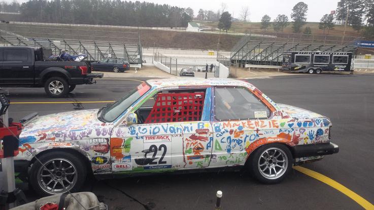

    I haven't used Fortune, but on the race car we run 15 x 8 et25 with 225/45 and there's about 2-3mm to the stock strut tube in the front using BFG Rival, the rear had to be pulled a little to keep them from rubbing (late model, low arches). Did the phone book stretch trick.
      What's the phone book stretch trick?
      Originally posted by kronus
      • ForcedFirebird
        • Feb 2007
        • 8300
        Jack the rear up, remove the spring (or use a couple friends for extra weight), heat the paint, then drop the fender with a phone book (or stack of magazines) between the fender and tire. This way you don't end up with a wavy/crimped roll that is weak, or removes the vertical body line. Basically it keeps the stock shape, just goes wider.
