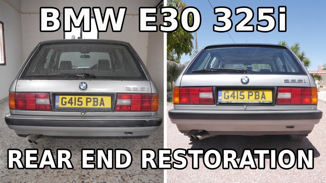

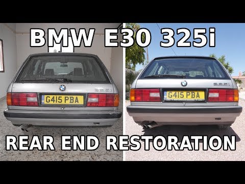

                        Not too hard, but looking at this video I'm coming back on my words and would just remove the spoiler after all.. :)
                        Around 4:30 the spoiler comes off. Around 7:00 the tailgate.

                          It looks like masking it in place might be easier.

                            Thanks for posting the video. Bookmarked for when I get around to the body restoration of my Touring!
