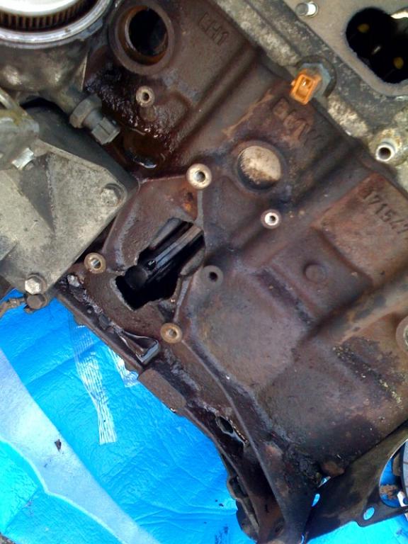

                Tell me about the screaming like a girl... check out this hole in my previous block!

                  Ouch, hurts seeing that... how did you manage that?
