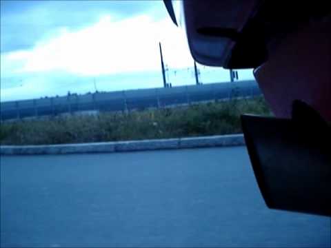

              One of the POs of my '91 318i sedan (also M42) put Borla mufflers and cut off the cat. It sounded horrible and looked stupid as the exhaust didn't even stick out all the way. I imagine I pissed off a lot of people here in my area and probably ended up getting laughed at from afar. I drove it like this for over a year before I got around to thinking about fixing it.
              Thought about putting a resonator to try and tame the noise but I ended up just buying a Supersprint catback off Turner Motorsport and a DEC aftermarket cat off eBay. Sounds WAY better. If you're interested, it sounds a bit like this:
                Great camera work and actually a couple vids that helped me decide on the Supersprint! Any chance you'd have the item # or link for that cat?

                  The DEC cat's part number is BMW1433. Bought it off bigredautoparts on eBay. Bimmerworld carries this cat as well. I had some fitment issues with the cat but I took the car to an exhaust shop to sort it out. The flange where the muffler connects to the cat was rubbing against the frame if I recall correctly. I'm not sure if it was because of the cat itself or how I had it installed onto the car.
                  As for the Supersprint, it may take awhile to come here seeing as they're on backorder and have to be ordered from Italy and brought to the US by ECS Tuning, (that also happens to own Pelican Parts and Turner Motorsport) which is the only company in the US that distributes and sells Supersprint exhausts.
