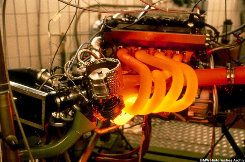

                          Or turbo them - the M10 block handled 1500hp in F1 qualifying trim
                          Click image for larger version  Name:	f1+turbo+bmw.jpg Views:	0 Size:	71.4 KB ID:	10039475
                          M10s aren’t a bad engine - in 2.0L injected trim (approx. 130hp) they’re pretty sprightly as a manual and lighter than the M20. They just need a shorter diff in them to liven them up as early e30s had a 3.64, which isn’t exactly short. A 3.9 or 4.10 would go well.

                            there was a lot attached to that block to make it happen. the s14 and m4x are also m10 bottoms. iirc it was the first winning f1 turbo as well. there's all sorts of urban legends about it from how they used ex taxi blocks to stories of them literally pissing on the blocks for some stupid reason.
