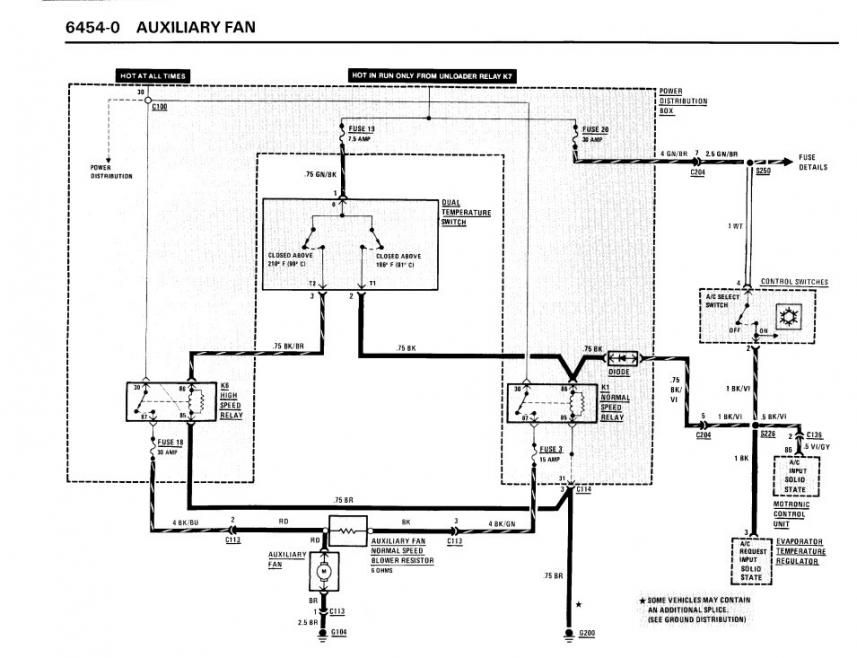

                -my fan only runs when jumped at the sensor plug. I know it’s rarely the switch but in this case it probably is. New one is on order.

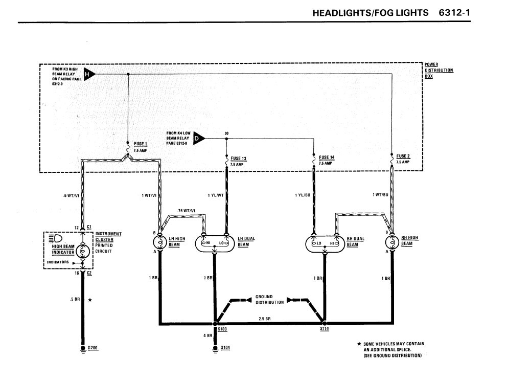

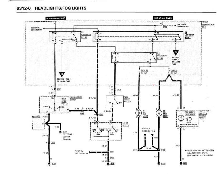

                -I’m running a KAmotors intake funnel. I only have one high beam. I’d like the low beams to stay on with the one high beam. I forget how, any pointers?

                      Fan runs when AC is on or the temp switch is kicked. Has high and low circuit depending on temp.
                      I thought the low beams stayed on with high beams?
                      The fogs cut out?

                        The low beams do stay on with the high beams, at least in the stock wiring.
                        I tried reading this diagram but I blew a fuse... I'll see myself out.
Name:	Screenshot 2022-08-04 102301.jpg

                        And yeah the aux fan only comes on low speed if the low temp switch or ac has been triggered, and high speed only when the high temp switch is triggered.
                        I think low speed was around 91 celsius and high speed was 99 celsius, or 196F and 210F.
                        Just checked, yup.
Name:	Screenshot 2022-08-04 103021.jpg

                            the fan issue was in fact the switch. I have it setup to trigger the spal fan at either the high or low speed circuit (since it’s the same speed with my 80/88 fan switch. Is this the lowest temp fan switch available? It still won’t fire when the A/C button is pressed but I’m swapped and don’t have A/C. Maybe I need to jump the compressor switch to complete the circuit?
