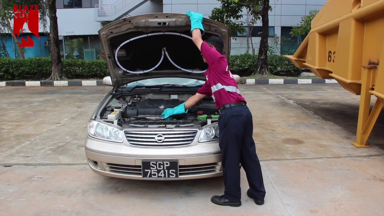

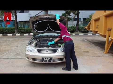

                  Watching the second car in this video has me thinking that an engine may be on fire for quite a while before there visible clues that its happening. If the windows are up I wonder how long it would be before its smelled or seen.
                  The other benefit of blazecut or systems like it is that its automatic. Sometimes cars catch fire after you've parked them and walk away.
