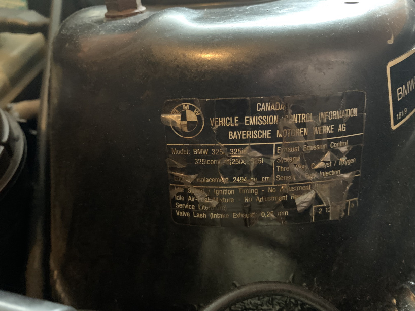

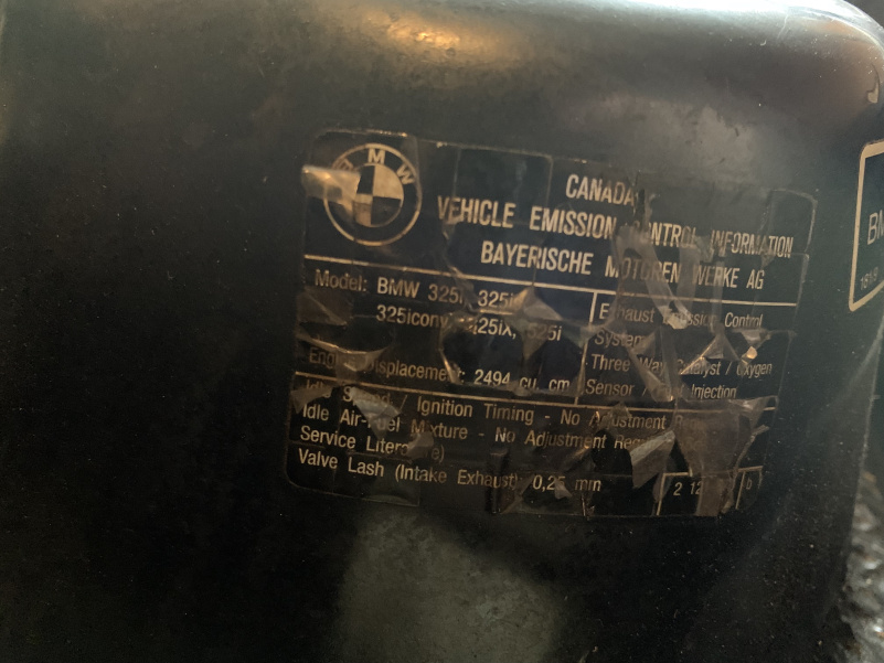

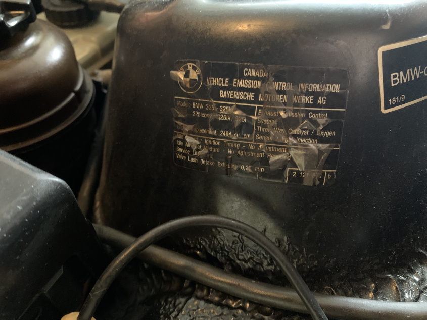

              Hey here's the Canadian emission sticker.
              I'm thinking this will be impossible. Got quoted $7500 to do CARB testing and modifications. Which is crazy since I didn't even give them the vin or tell them it was Canadian. All I said was the make and model - just goes to prove how much of a racket CARB is.
              I think plan now is to try and sell. I need a title, unsure if I can get one without registering though.
