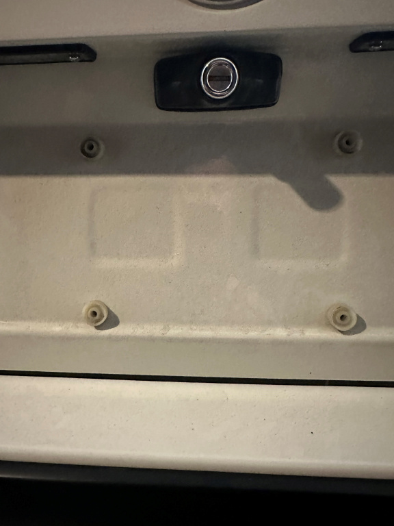

    Hi all,
    I'm having no luck matching the rear license plate screws. My car came with 2 (that fit), and I'd like to add 2 others (well, really, I'd like to replace them with 4 stainless screws, but I'll settle for another matching pair for now...)
    According to realoem, it should be this:
    07143448498 Fillister head self-tapping screw ST4,8X16MM
    https://www.realoem.com/bmw/enUS/sho...37#51181821830
    I ordered those, they didn't fit.
    So I took the screws that were holding the plate on, went to the hardware store, and wasn't able to match the size/thread (ugh).
    This is what my plate holder looks like (is this even OEM)?
    Thanks for any help. Much appreciated
    1992 318i cabrio Alpinweiss 2
    2006 ZHP cabrio Imola​

        Most likely, you need to replace the plastic inserts first.
        https://www.realoem.com/bmw/enUS/sho...62#51181852299 ​

          • WestCoastEta
            • May 2015
            • 475
            I replaced mine with M5 x .8 bolts from the hardware store and they did the trick
            • sna77
              • Apr 2023
              • 206
              I tried those--because that's exactly what I use on my e46--and they did not fit. I'm thinking my plastic retaining nuts are not original and just some generic thing. Ordered the OEM retaining nuts and will try again.
