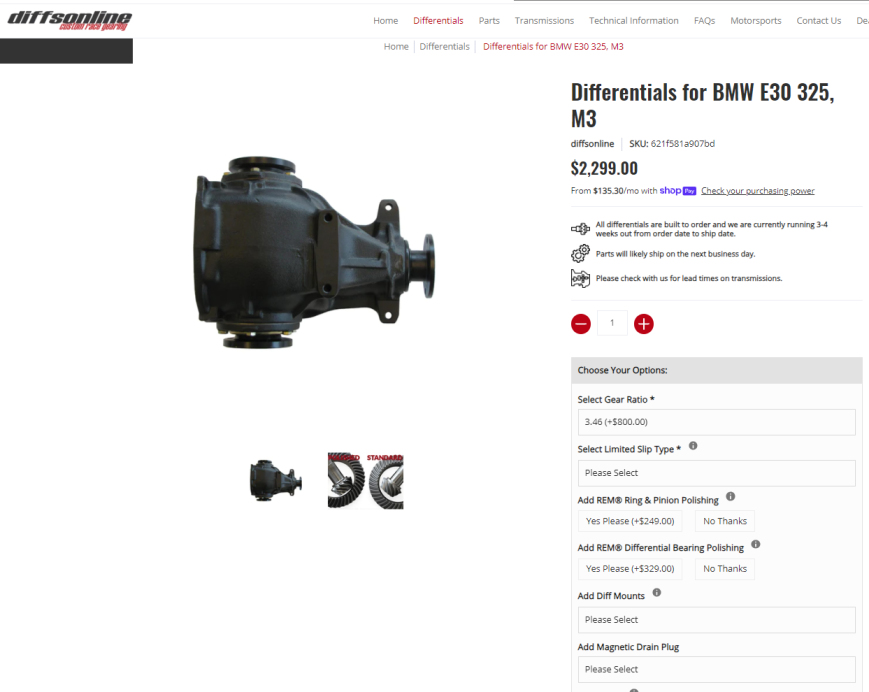

        I had mine built by Diffsonline.com. They'll build you a LSD to your specs...

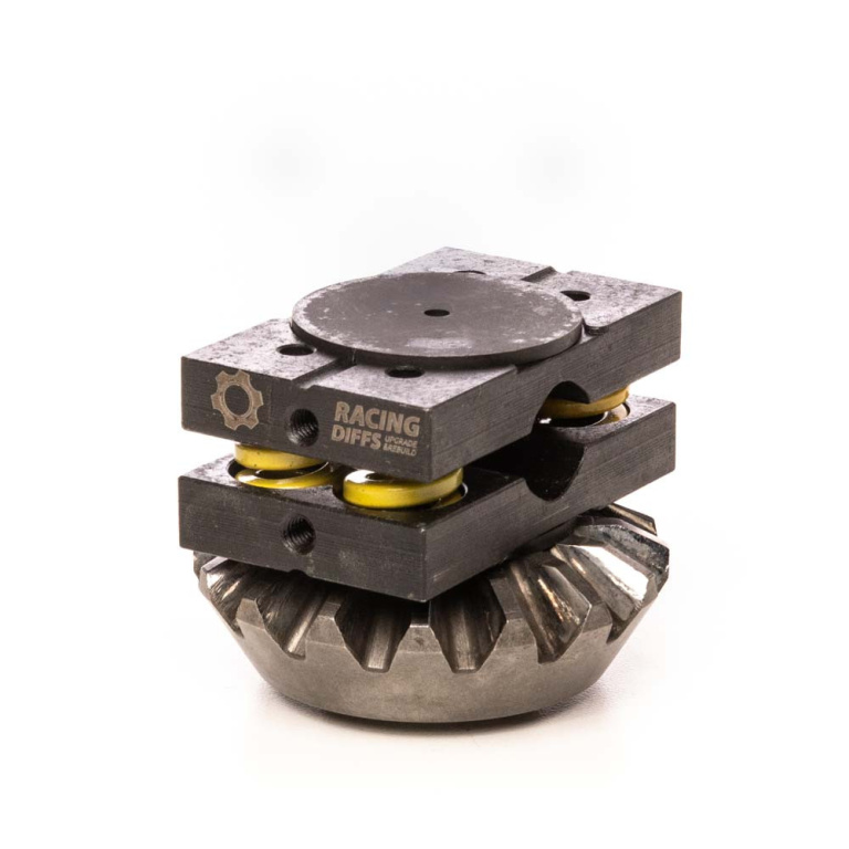

          just don't get the fake ls center unit they use. make sure you buy a real one.
          edit : maybe that's a racingdiffs product.

          yeah, that thing.

            yes, wrong company. diffsonline has been around forever and you can fully customize your diff however you want...

              Thanks for that. I’ve looked at diffsonline and considered that route as well. More money but you get what you want!
