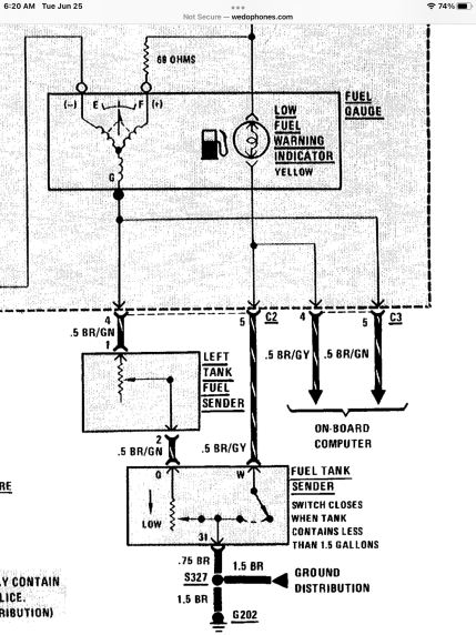

            A couple of things, you have two senders in an 89 wired in series. Both have to be working for the gauge to work. The test for the sender is usually conducted with resistance check not voltage. Hopefully “ 60 volts “ is a typo. If you haven’t downloaded the 89 ETM yet the pic below is an 89 image of the sending units.

              So if my car starts and drives, my left fuel sender may be bad in some way to not make the guage work? and where did you have to soulder to repair the board, and which board the SI board or the board that holds and the bulbs and clusters?

                I would have to check continuitey between the two pumps maybe? Or would the left sender also have a sensor in it like the one on the passanger side?

                      it's mapped out above in the pic from the etm.
