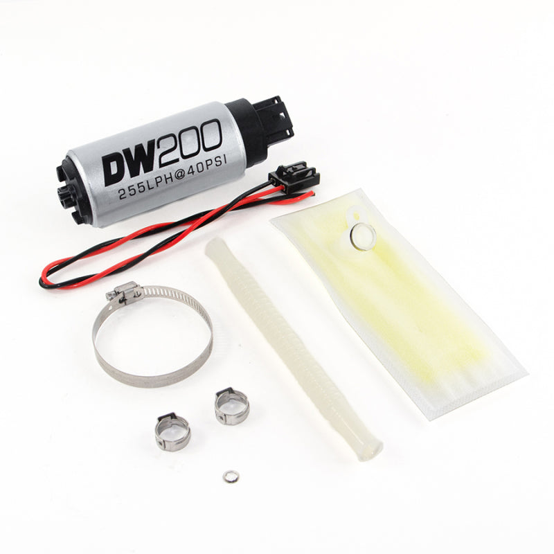

    A lot of searches lead me to the Deatschwerks DW200, but it sounds like overkill for the in-tank pump. I don't see a kit specifically for the E30, but I see a universal one:
    https://www.fcpeuro.com/products/255...rks-9-201-1000
    and an E36 one:
    DeatschWerks, LLC provides high-performance fuel system solutions for the automotive aftermarket. Located in Oklahoma City, OK, DW houses all of the company?s functions including design, end-manufacturing, quality assurance, sales, marketing, and administration in its 36,000sf facility. DeatschWerks? roots were establi
    But I feel like that's an overkill (and possibly loud) solution.

        wait i didnt catch that you are using the DW200 as a transfer pump, no wonder its noisy, its basically dead heading against the "main" pump.
        you really want a high flow low pressure, high flow lift pump to feed the high pressure pump. it will specifically be an internal pump
