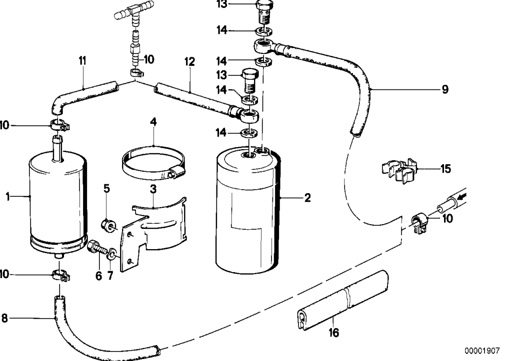

                            I was going to say the pump isn't going to have any effect on the FPR/injectors in this situation but after looking at the real OEM diagrams I'm not sure. It has all the rail mounted FPRs grayed out. The 323 does have a fuel rail mounted FPR, correct? If so, it doesn't matter what pump you run as long as it's not dual a1000's with -8 line or something crazy that would overpower the regulator.
                            Jerry, does your car have this weird fuel "separator"? #2? That's crazy.
