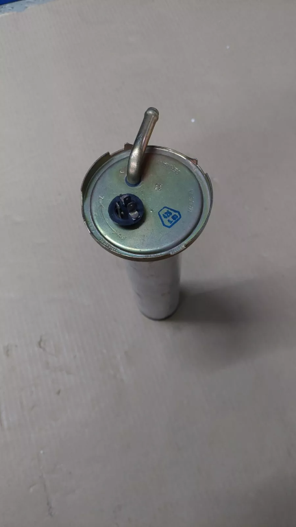

                My 85 323i had the large circular level sensor pick up similar to the one pictured. So what I did was retrofit a TRE/Walbro pump onto an early US model carrier that has both the fuel pump lines and level sender then deleted the external pump. Click image for larger version  Name:	image.png Views:	0 Size:	211.9 KB ID:	10128847

                  Yep that’s what I have, but weird that yours is a single hose. Anyway I just grabbed the correct early housing. I might just use the lift pump currently on it and see if it quiets the main pump. If not, I’ll will work on a wallbro mod

                    That was just a photo I found online. I have the actual unit somewhere in a box.
