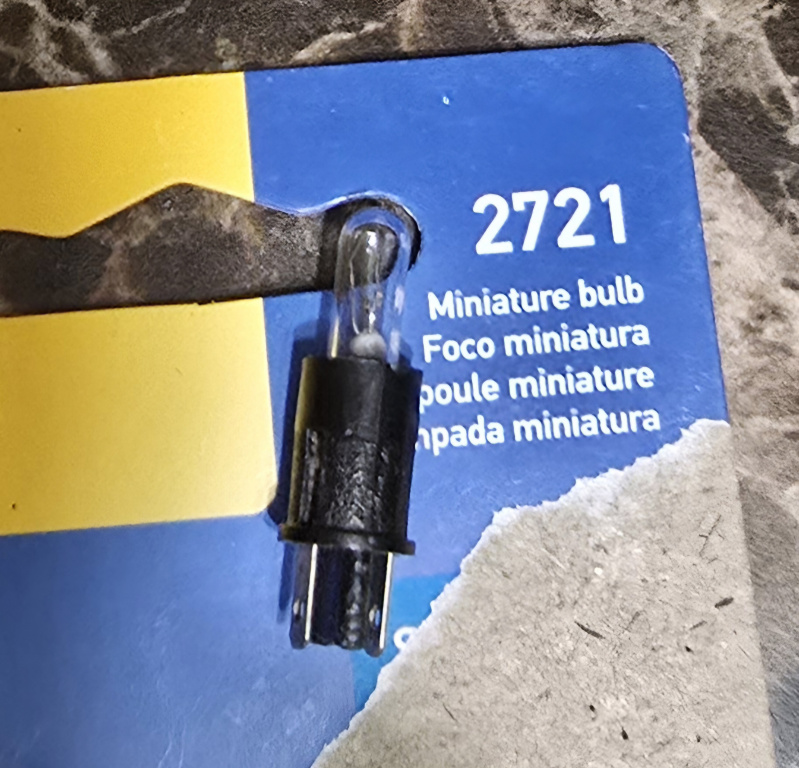

                should be a w1.2w - osram/sylvania 2721

                  Awesome thank you! I was digging around and saw some posts with that mentioned but no confirmation.
                  Ill circle back when I get the bulbs and replace to confirm fitment
                  • Enriquez2000
                    • Apr 2024
                    • 152
                    ​ This is correct part number!

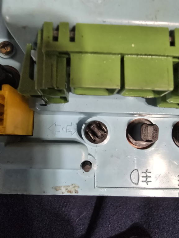

                    Now does anyone know which wires go here... i have cel and what I believe to be abs but no leads for this
