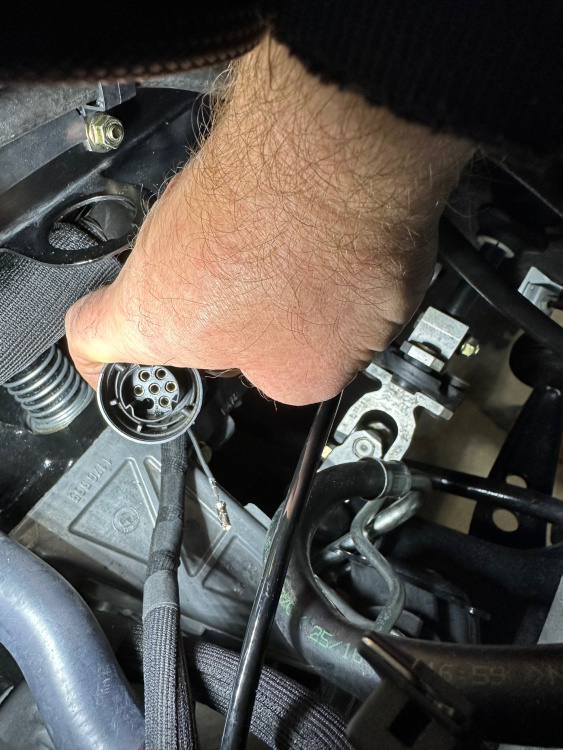

            a) I want to keep dizzy no mater what. Yes weird but It's 80s car and I want to keep something from 80s.
            b) I have Nexus S2 so it's only 4 drivers
            I didn't want to hack stock harness so here is pnp harness/adapter/brackets I built. Pretty much stock with the exception separating IAT and temp sensor grounds to a dedicated signal ground (all using stock harness) and now rewiring oem injector harness to get these injectors in groups.
            Click image for larger version  Name:	IMG_8786.jpg Views:	0 Size:	207.2 KB ID:	10130944

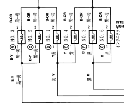

                  for example here is stock JZX90 in the diagram below ( the same 153624 firing order but has the cam sensor). Pretty much Link ECU suggested pairing only shifted 120 degrees. My tunner insists I split injector from the batch of 2 (e30 stock) to Haltech semi-sequential aka the batch of 3 to dial in engine response and low rpm operation.
                  not a big deal at all, even using stock e30 harness. Luckily, OEM Motronic 55 connector has plenty of empty slots. All I have to do is to take a useless wire in e30 injector plastic housing harness that is going to c191 (one wire on the fan temp switch is useless because the switch is grounded through the body hence the switch has only one pin but its brown plug has two wires there), cut useless wire from the brown connector and redirect that wire to the 3rd pair of injectors. Now c191 7th pin will drive my 3rd group of injectors. Harness's end of c191 has only 6 pins so I'm adding the 7th 2.5mm pin in the empty 7th slot and running a wire back to Motronic 55 connector into the empty slot. Easy job.
                  One wire mod. Just want to understand if the Haltech suggested pairing is what I should do and why ....or do something else.

                    Thats interesting on the jzx90. paired as you suggest. 5/3,4/1,2/6
                    I would be inclined to give haltech an email or phone call to get their opinion as to why they have suggested what they have and tell them about your theory and the jzx evidence. Everything i have heard suggests they are responisive and helpful. I emailed them yrs ago about an issue I had on a very old ecu (E8), and they even responded to that very quickly.

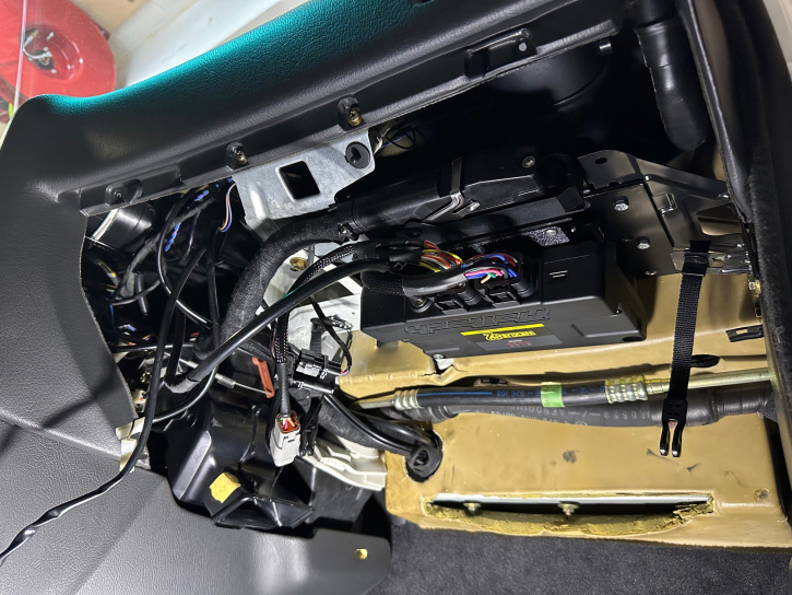

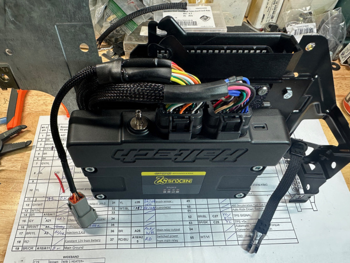

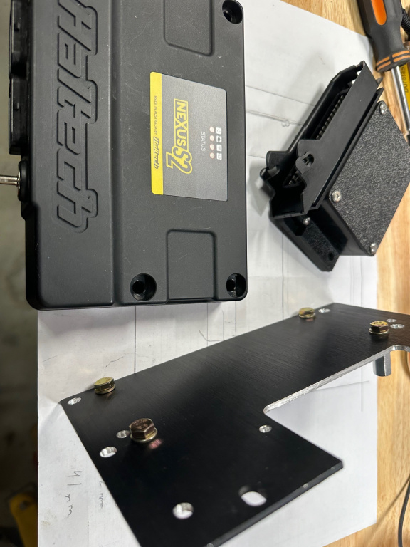

                            Everything is wired and ready to go. Actually was pretty straightforward job. One wire back to the ECU and one new pin in the empty slot of the stock harness connector C191. Injector harness plastic rail just needs wires separated and unused wire crimped to 3rd injector group hence no changes to its c191 plug.
                            ECU is installed and fits nicely under the glovebox upper trim just like stock. I went with Nexus s2 because for the price, it is actually not a bad buy considering all it features (built in LSU 4.9 wideband controller, knock, wifi, app connection, throttle by wire if one what's to go that route plus newer processor etc etc). Nexus S3 would make more sense for 6 cyl but I never getting rid of the dizzy on this m20, otherwise I would have just swapped it instead of building the stroker.
                            Now to the fun part. Hopefully it will run haha.
