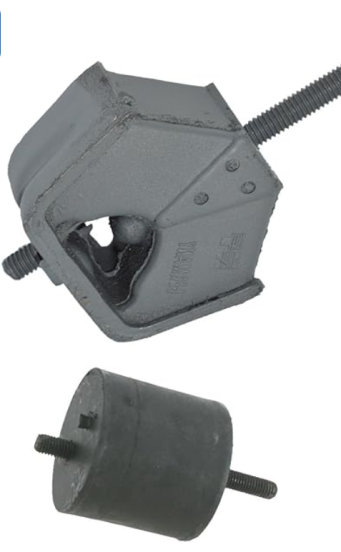

                    Follow up question regarding e28 M5 mounts... RealOem shows that the M5 had 2 different types of mounts for the right and left, like in the picture I've attached... My car has the top mount (but green color) on both sides... Those of you using e28 mounts for your swaps, which of these mounts are you using?

                    • MR 325
                      • 37833
                      Originally posted by RenaissanceMan
                      I don't have e36 arms, just the stock e30 ones. I currently have e28 mounts on the car now but they are definitely in need of replacement.
                      I have never heard of someone using E30 engine mount arms for a S52 swap. Are you sure?
                      Grover Beach, California
                      BimmerHeads.com
                      • MR 325
                        • 37833
Name:	Screenshot 2025-01-31 180821.png
                        You want to top version. These are the same geometry as your existing E28 mounts.
