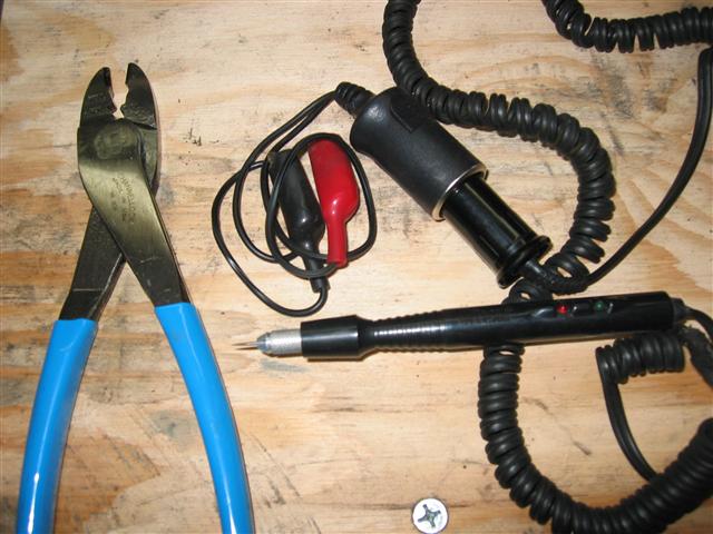

        Just in case you guys are curious about what Luke thinks are good tools:
        Crimpers, channel-lock or go home
        Test-Light, I have "The Probe", but one of these nice doohickeys.
        He gave me the lecture many moons ago, so I bought the tools.
        Luke do you have a picture of the garage door in Eugene? That'll sell some fool-proof remote starts. :-)
Name:	tools 001 (Small).JPG
