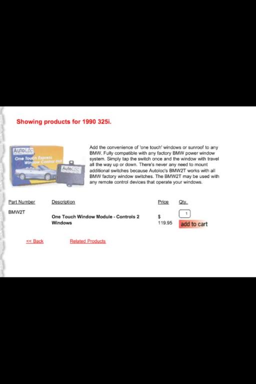

                                1. The GM system WILL NOT do a proper "one touch" using the BMW 1T switches: there is no way to toggle it on the 2nd click. The GM module also will not trigger from an alarm without the use of a 2nd module.
                                2. Aftermarket window control modules also will not operate with the 1T window switches, you have to use the "big wire" switches, which are not as reliable as the late "small wire" E36 switches, however you do it, you will not have proper 1T switching like a late E36 has.
                                3. The comfort module from a late E36 plugs into a huge circuit board with roughly 9 billion connections. Good luck adapting that, or finding a way to reliably attach wires so it could be adapted to the E30.
                                If your car has individual plugs that connect to that board, please let me know. I will find another and hack its guts out.
                                I really do wanna see that, but damn what a hassle. I have held one in my hands. It is gonna be a bitch. That "Comfort Module" is one of 2 or 3 modules on that board...
                                I think you guys who want 1T would be best served with DEI modules. They are overpriced and failure prone, but still, they are the easiest option to get 1T and can be triggered by a separate switch to do all 4 up/down, or controlled through an alarm.
                                Here is a .PDF of the installation instructions for the DEI 530T:http://www.directed.com/guides/manua...N530T_1-00.pdf. $60 at Frys.com, controls 2 windows up AND down. If you have a 4 door, you will need 2 modules.
                                You still will not have proper 1T as BMW uses on late E36s, but it works and is fairly simple to install. You can use E30 switches, big base E36 switches, Jetta switches or small base E36 and 2 relays per window.
                                Personally, I am holding out. I have my Scytek modules which give me temperature venting and I love that. I will find a way to get the proper "2nd click" 1T operation working. It is 100% superior to any of the aftermarket systems, best window controls there are.
