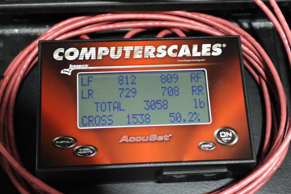

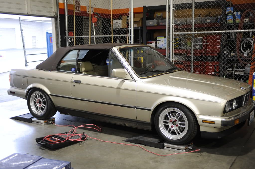

    But how fat am I supposed to be?

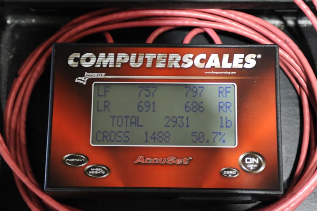

    My cousins IX came in at 3020 without him in it (dont rempember the fuel level though,,,Daym), I was under the impression that Cab was a bit heavier...
    Heres where she came in...
    This was all for giggles btw, the car is on crappy springs so no corner-balancing adjustment were made... Pretty good almost 50% with me in it.
    Some glovebox clutter, clean trunk, about half tank.
    With me in the Driver seat

                        Don't feel bad John, mine weighs in at a healthy 3150 w/ half a tank :)
                        Convertibles also have a nice, fatty weight in the trunk behind the passenger's side wheel well to stabilize the handling. If you're feeling adventurous you can relocate the battery back there like on coupe/sedan cars and ditch the weight. It's a PITA job though.

                          • nrubenstein
                            • 3148
                            I love the cut down rhino ramps.
                            That's not much heavier than my 330is and almost exactly the same up front.
                            2896:
                            757 773
                            683 683
                            IIRC, that was around 5/8ths. Sadly, my ass is a lot fatter than yours is, so I weigh more loaded. Mine is about as heavy as a non-iX gets, though. S50, A/C, lukebox, two amps, big battery, leather seats, thick carpet, heavy ass BBS RXes....
