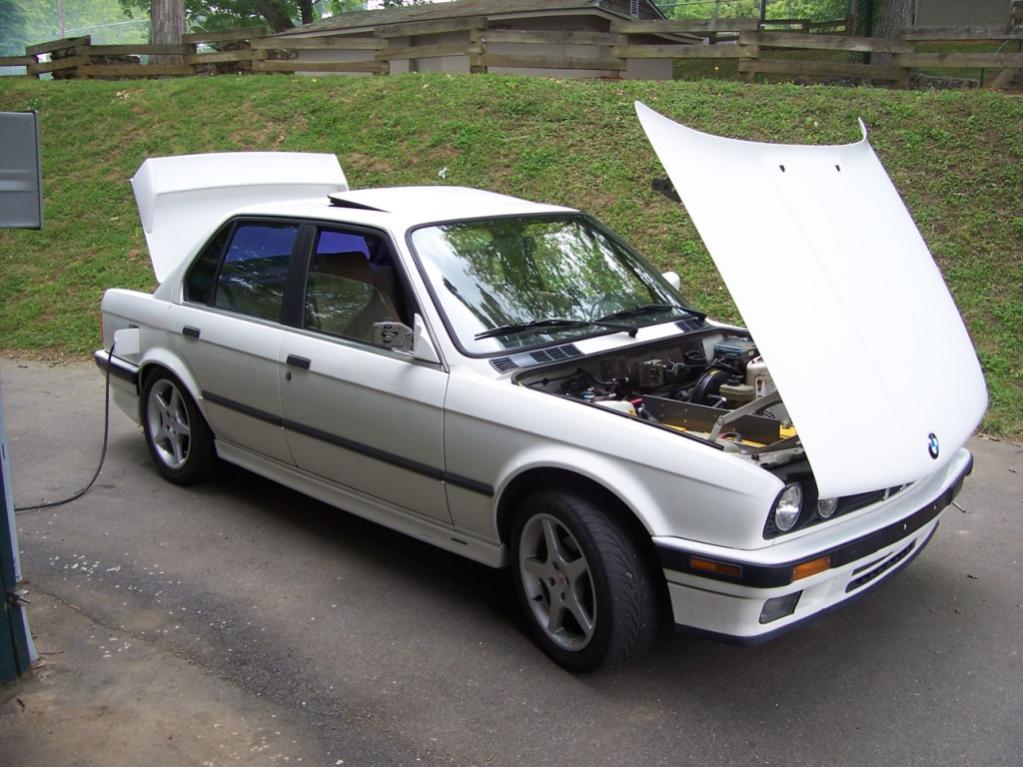

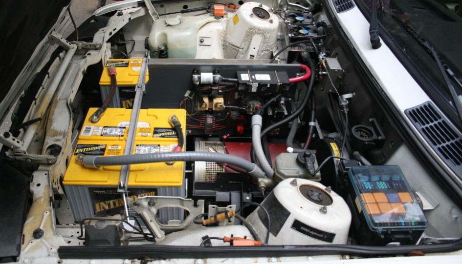

                      I converted my E30 to electric and love it for commuting to work. I have autocrossed it and was a few seconds off the gas guys. I started with lead acid batteries so my range is ~25 miles. Only spent 8K on it though including the car. I will do lithium as soon as this pack dies. Check it out:
                      EE30 Build
                      Lithium is going to cost you quite a bit for a 60mile range. It will probably be in the 15K+ range when you factor in the battery management/monitoring system that you should have for lithium.
                      1990 EE30 156V Electric Conversion
