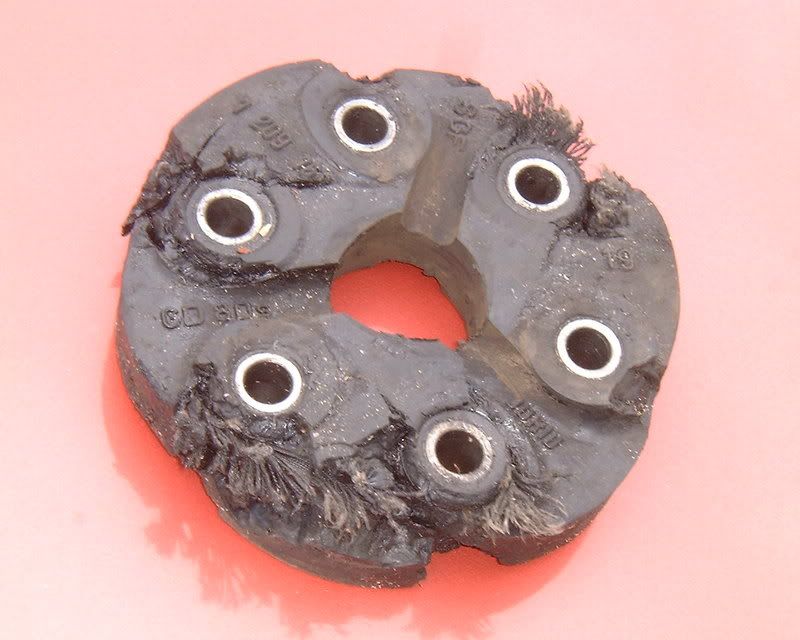

    Guys, lots and lots of us change our vibration dampeners (giubos) every year. and nearly ever other time i dig into a car i see them backwards. This needs to become general knowledge. The arrows on a giubo need to point towards the mounting surface, not away from it. putting it on the wrong way will cause the it to die very fast and suddenly.
    btw it's "giubo" not "guibo"
    the arrows ALWAYS point to a flange and NEVER points to a head/nut.
    Wrong:
    Doing it worng
    Right:
    Doing it right
    after a few hard pulls it will look like this:

                close. there are 6 arrows on the giubo. three point one way, three the other, alternating. all 6 flanges get an arrow pointing towards it. 3 on the transmission output and 3 on the driveshaft.

                  Arrow always points to metal, not the engine. You can instal a Guibo backwards if you follow the "towards the engine" rule

                    I dont get the difference between the right and wrong. They look like the exact same orientation. The arrows are pointing to the nuts on both pics.

                      no, they are pointing in opposite direction.

                        The nuts are not what is important. The arrow points toward the side of the guibo which should meet with a flange at that point.

                          I know what you are hitting on. I did not word it right, those notches go on the drive shaft not on the output flange on the transmission. Not talking about flipping the disk over. I was talking about the arrow in the second picture down bolting to the output flange on the transmission.

                            You want the arrow pointing towards the flange that hole is connected to.
                              your not describing this too well. If there are arrows pointing opposite directions, then orientation should not matter. But it does. So there is something your leaving out.
                              Also pic with the guibo doesnt really show a difference where the flange should be
