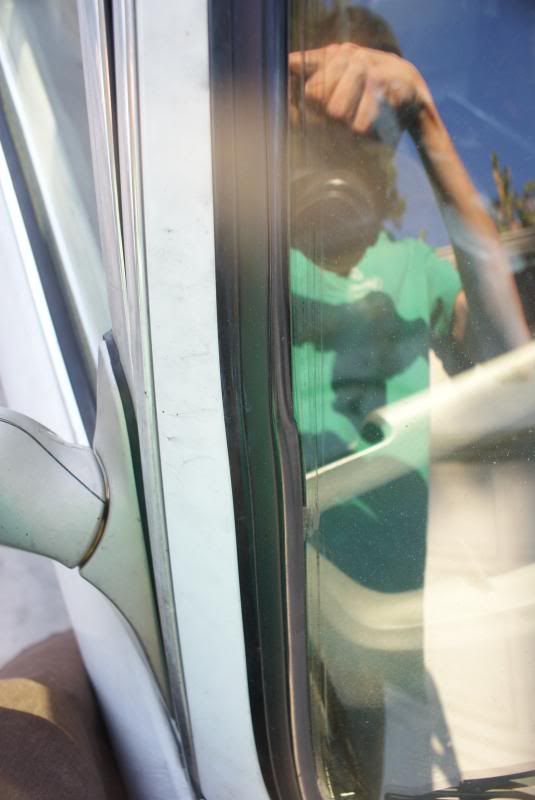

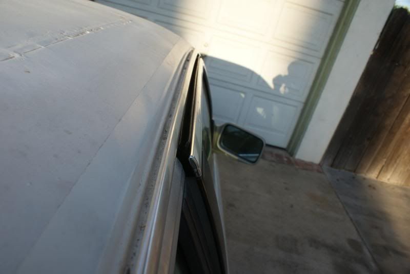

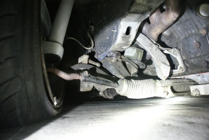

    had too much fun at the track this weekend. I think my car is finished what do you guys think?
    the window started to pop out!!

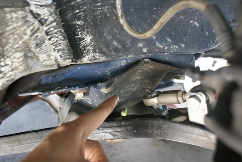

    Are the rails bent? I can't tell.

      Even broke an engine mount arm, pretty intense. If it's your DD then I think its time to part it man. Maybe you could replace the subframe, but like AK- said, bent rails?

              got to close to a clipping point. dirt dropped with my right front,rim caught the 5-6 inch lip of tarmac. I was in 3rd gear so about 50-60 mph when i hit.

                did the end link smack the frame? did you run over the gatorback?
                edit: there's the answer.

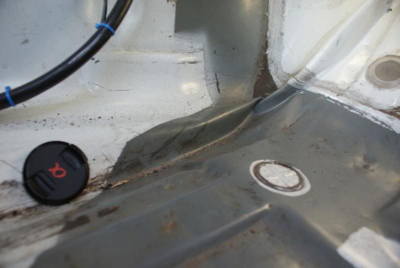

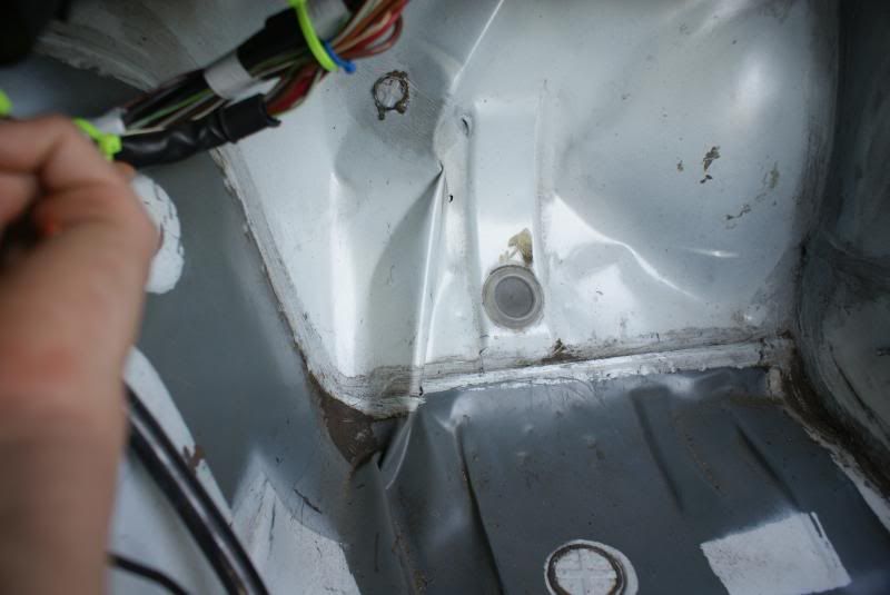

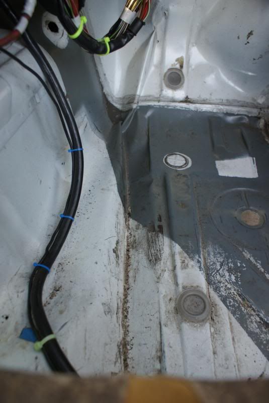

                  the frame is bent. how much? its hard for me to tell by eye. maybe 10mm or more. its hard to see in the picures but i think the wheel smacked the frame rail. the rail has a good dent in it about 5 inches long vertically. i can see the mounting area for the subframe is pushed up, its no longer flat.

                            Is the passenger door closed in that pic? yeah, if the windshield gasket moved like that, it must have been a pretty hard hit. Years ago, I would have said junk it and find another shell but these days clean E30's are scarce so take it to a frame shop and see what they say first before looking for another shell.

                              that thing is def. trash now. Doesn't look like it was too clean of a car either (sunroof hackjob)......
                              I wouldn't want to be in that car if there was another impact in that area.
                              It's crazy how strong yet weak the E30 chassis can be in different accident situations!
