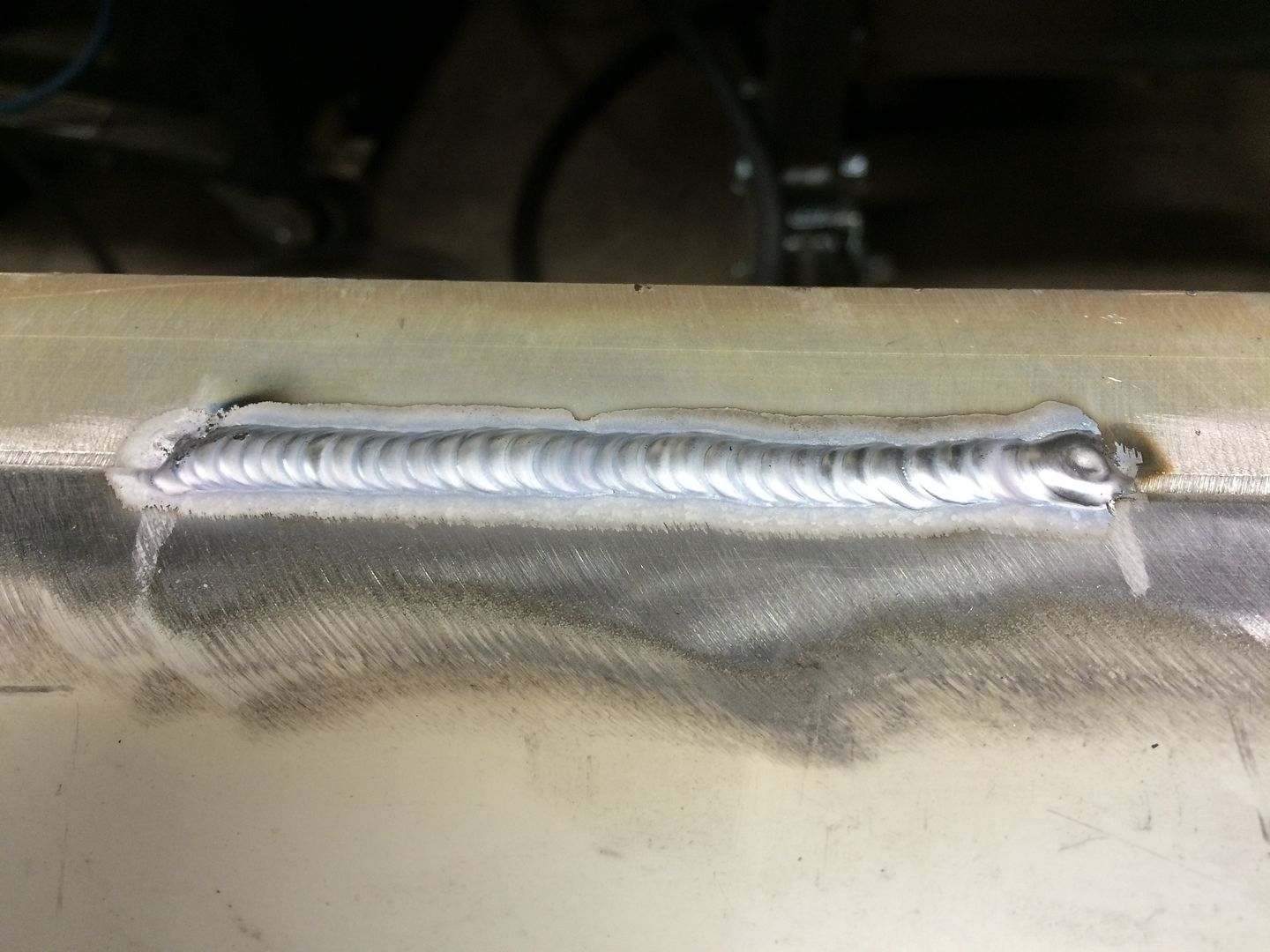

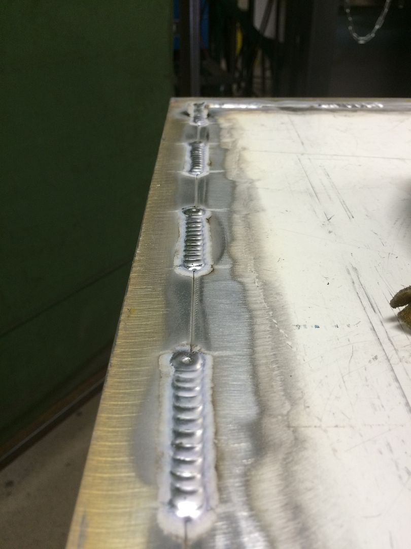

        Finally got the machine set right to lay decent beads on 1/4" aluminum...
        Still haven't been happy with the tungsten. I've found a steeper angle on the tip causes it to blow out less. It's a grey 1/8" rod, gas lens, 215 amps with the balance turned more negative than positive to try and get the heat off the top. Still globs up to one side.
        Freshly sharpened
        After the first pass
        • flyboyx
          • 8371
          #229
          with aluminum you normally use reverse polarity a/c, continuous high frequency. the tip is supposed to ball up.
          when i welded aluminum in a shop setting, we would hold the torch against a metal table and stomp the pedal for a few seconds to get the ball on the tip before we started our welds.
          also, i was taught that its best to sharpen your tungsten so the grind lines are parallel with the length of the rod.
          i guess there are people here that have welded more aluminum than i have that can chime in with more advice.

            The tungsten needs to be sharpened to a tip, with the cone being more or less symmetrical. I roll the tungsten between my fingers, against a bench grinder. It should come to a point like a pencil. To ball the tungsten, set the machine to DCEP and slowly press the pedal until it balls up to where you want it. Too hot too fast and you'll burn the electrode.
                You're still running too cold... 260A is about where you should be at. Running more DCEN is good, but you need your amps right, and you actually can run a sharpened tungsten instead of balling.
                Otherwise, it looks good. Are you adding any helium? Or straight argon?
                        Freshly sharpened
                        Not sure what grey us without looking it up but I use 2% lanthinated. Also, a great way to sharpen your tungsten, stick it in a cordless drill and fire it up against a bench grinder. you'll get a very nice even point with all your grooves running parallel with the rod. I didn't see anything about pulsing so I'm guessing you're pedal pulsing. Looks good, just slow up and really ease off the pedal when you're finishing a run so you don't get those big finish craters on your final dimes.
                        It looks like he's beveling the material, 260amps is overkill. With a bit of preheating and bevel I have done 1/4" with my Lincoln 175 in small stints and get full penetration without an issue.
                          When I slowly let up on the pedal, I was getting centerline cracks pretty bad. I'm shoving a ton of rod in at the end and letting up on the pedal watching the puddle shrink down as I go. I'd love to have no craters, but I'd take craters over centerline cracking! I'm about to do some more on this project, So I'll work on the ending some more.
                          No Pulsing, just throttle control myself. I tried pulsing, but I'm not used to it, so I decided to just stick with what I know. I have scrap from this project so I might practice pulsing when this is finished. I had it up to 250 amps and it was just wrecking my 1/8" tungsten. with the bevel, 215 amps feels like a happy place.
