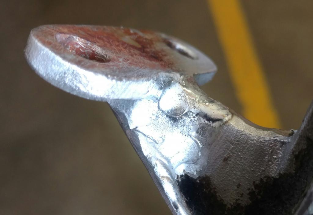

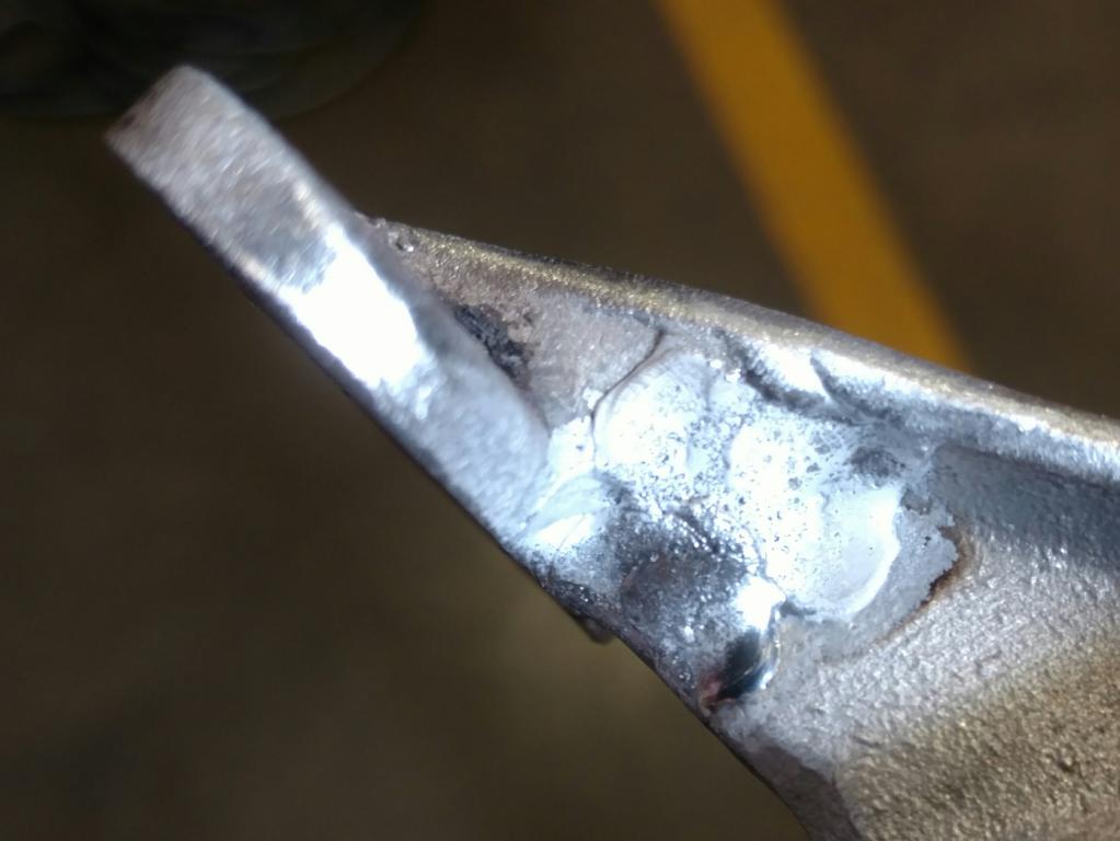

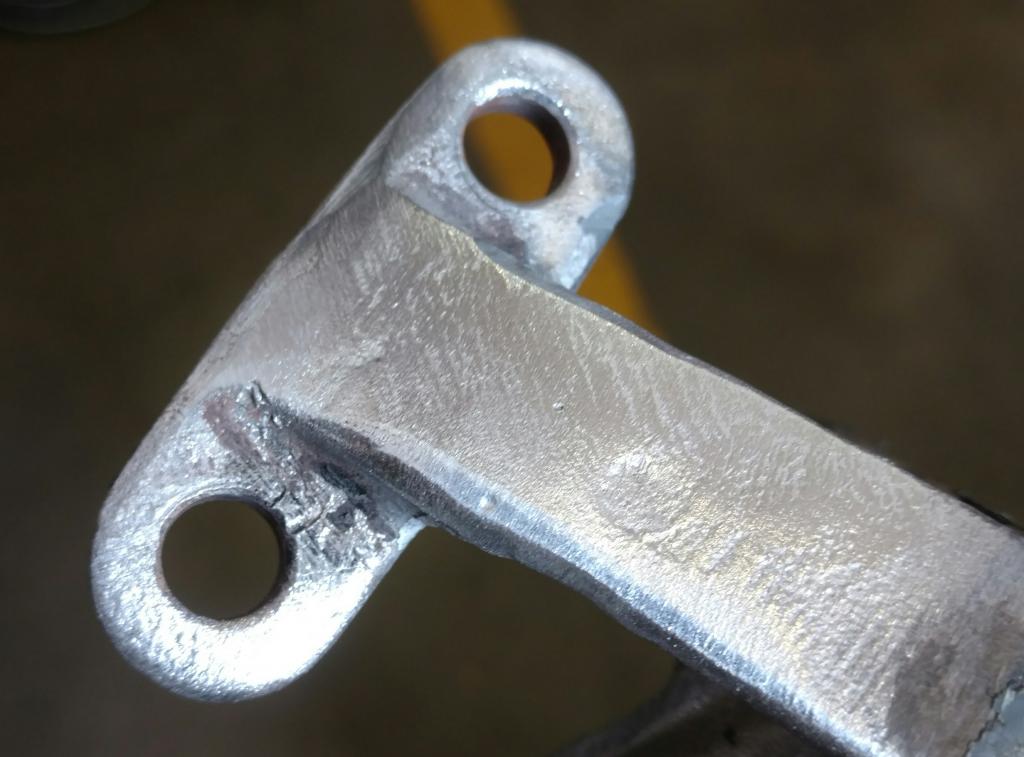

                        Work asked if I wanted to take a shot at this cast aluminum. Not one to turn down an opportunity, I went for it.
                        I'm happy with the results, first time. Definitely had to learn an entire new technique on this one.
