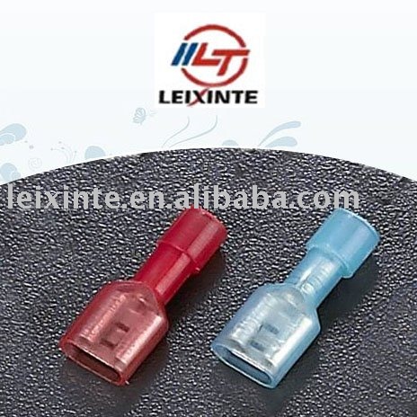

                      #70
                      Originally posted by Kershaw
                      In a pinch, you can just crimp on the female end of an insulated spade connector and shove them on. If they're not tight enough, just squeeze them with pliers. I actually ran them like this for... 3 years. So that's another questionable repair that lasted a long time.
                      THANKS!! Picked up some spade connectors and now have working lights!
                      • Das Delfin
                        • Sep 2014
                        • 2293
                        #71
                        ^ I tried to find oem connectors for smileys but when I realized how expensive it would be to buy them new vs how shitty used electrical connectors off a junk car would be, I crimped them together and wrapped the wires in electrical tape. Done and done
                        • Kershaw
                          • 11822
                          #72
                          Every so often one might come a bit loose and one headlight won't turn on. Just figure out which spade connector is loose, squeeze it a bit with pliers, and reinstall.
                          You can find the yellow connectors on e36s at the junkyard. Next time you're there, snag a couple.
