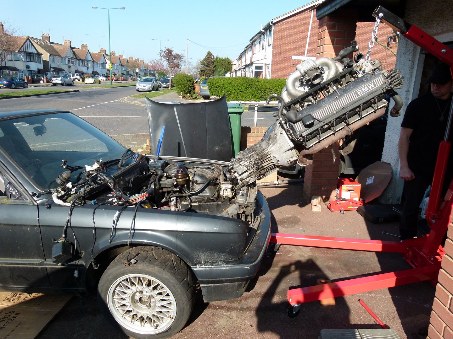

    I came to a point where I was happy the shell was perfect and I could start the conversion.
    Relieving the 3.5i from its rusty tomb 8)
    Hmm..getting it out took minutes compared to building the crane up lol
    There we go :D
    and here we go. . .
    Easy does it..
    My arse was well and truly twitching here! :eeek: :loco:
    On the home stretch! !
    Thats how you do that...Word of advice for anyone doing this conversion in the future..this engine is HEAVY! Like seriously heavy..

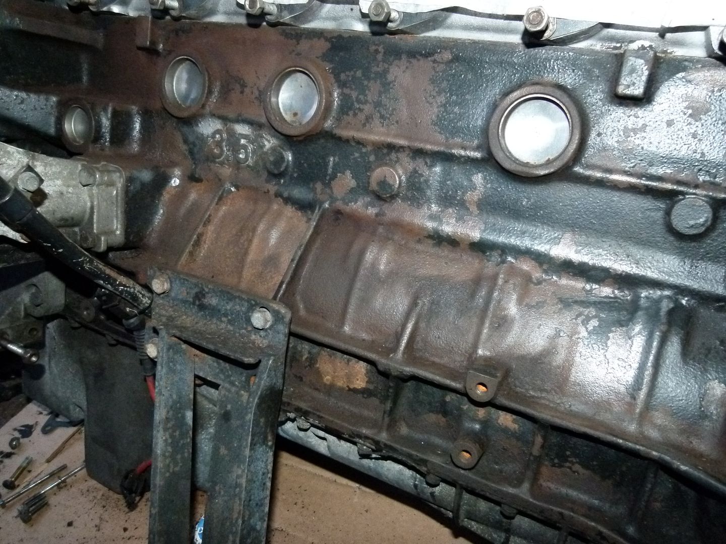

    I then got to degreasing then wire wheeling the block of all the old paint.
    Before:
    After:

    So the time had come to remove the 2.0i to make way for its bigger brother:
    So the day has come to remove the M20..and what a PAIN IN THE ARSE THAT WAS! :eeek:
    This was harder to remove then the M30 was, most definitely due to the auto box! :-x
    In the end it took me My brother AND my dad to prise it out of there!
    Didnt get as many pics as id liked to have but it will have to do!
    How the day started.. Removed the prop, exhaust, bonnet and got to work in the engine bay!
    and after a lot of struggling, swearing, lifting, pushing...it...was...out! :D:D

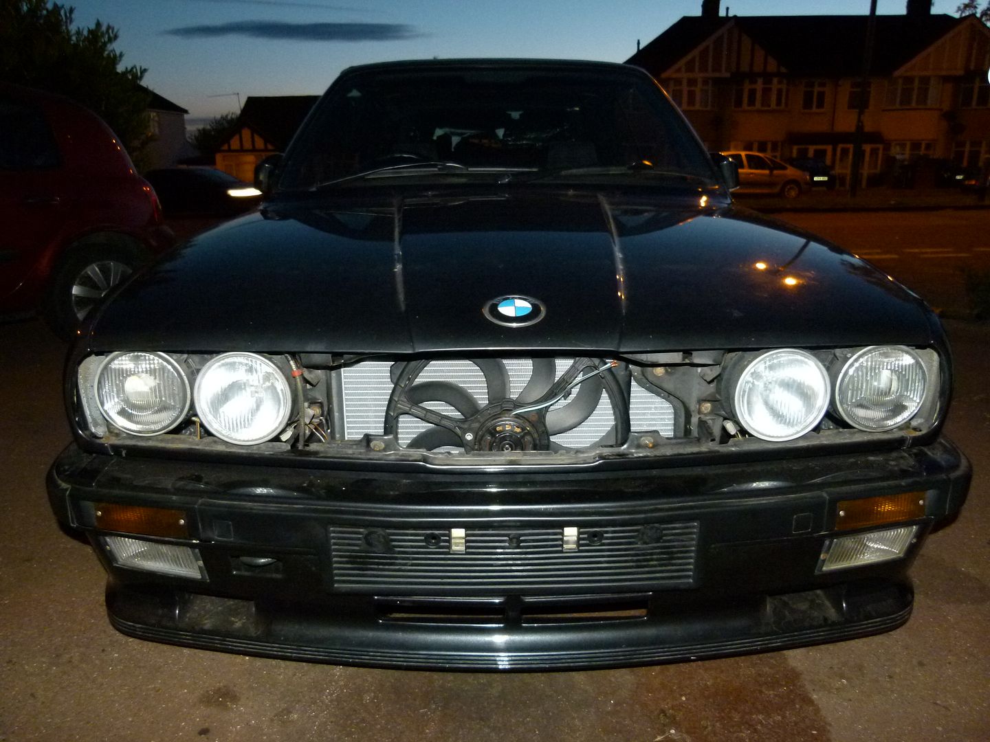

    Radiator and fan set up.

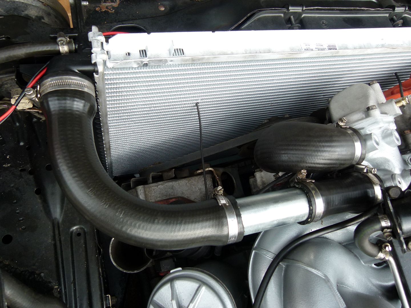

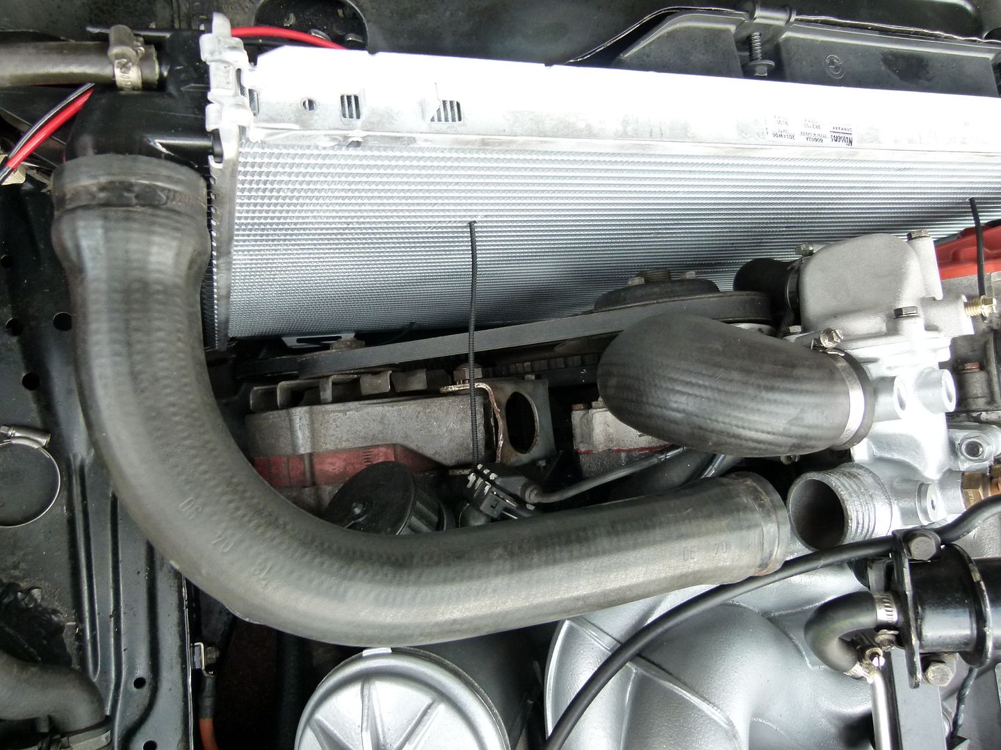

    The M20 radiator wasn't up to the job of cooling this enormous engine so i sourced an E28 radiator and went about using an old BMW fan i had lying around:
    I then moved onto slimming down the Bmw fan im going to use:
    Before:
    After:
    Used a bit of rust prevention while the radiator was still out:
    I used headlight securing clips and screws to secure the radiator in place:
    A bit of precision :roll:
    Then I noticed the gap inbetween the panel and the radiator and had a look to see if the original mounting bracket would fit
    Nope..I still didnt like the way the gap looked so i got the spare one i had and made a slight modification
    Much better! :D
    I then moved onto measuring up the fan
    Plumbing it in.
    The pipes were coming up short as they were made to fit for the M20 rad! :-x
    So i did a bit of a temp fix and used a bit of pipe I had lying around until I could source some pipes..

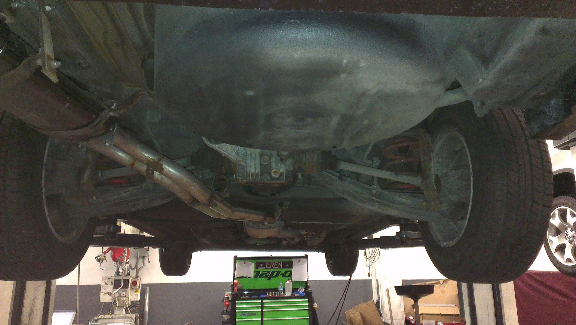

    replacing the diff as I didn't think the original small case 2.0i Auto diff was up to the job lol
    And in!

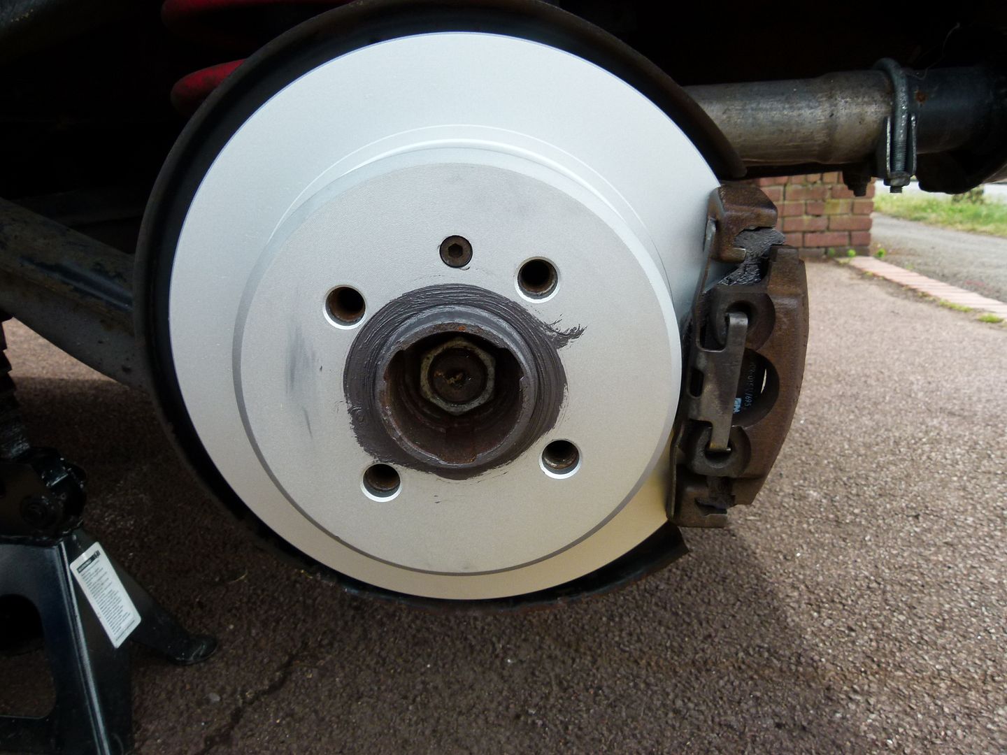

    Replaced the steering rack gaitors
    Replaced the wheel bearings
    Back on the springs
    Found a seized caliper (which I later replaced)
    and also a Seized outer balljoint for good measure :-x

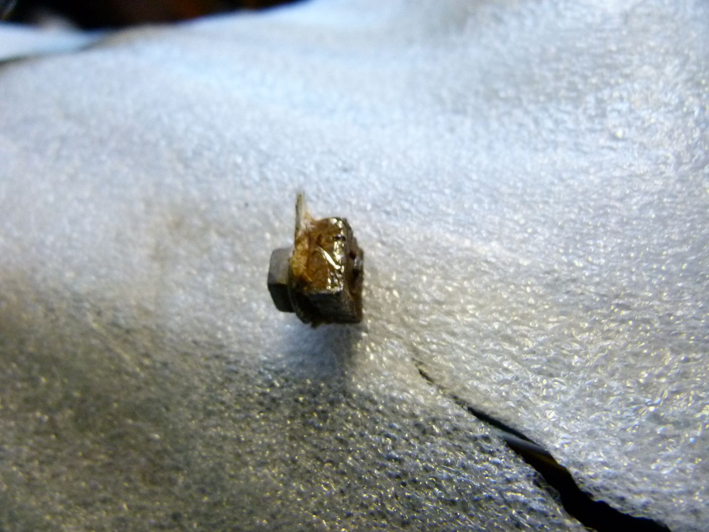

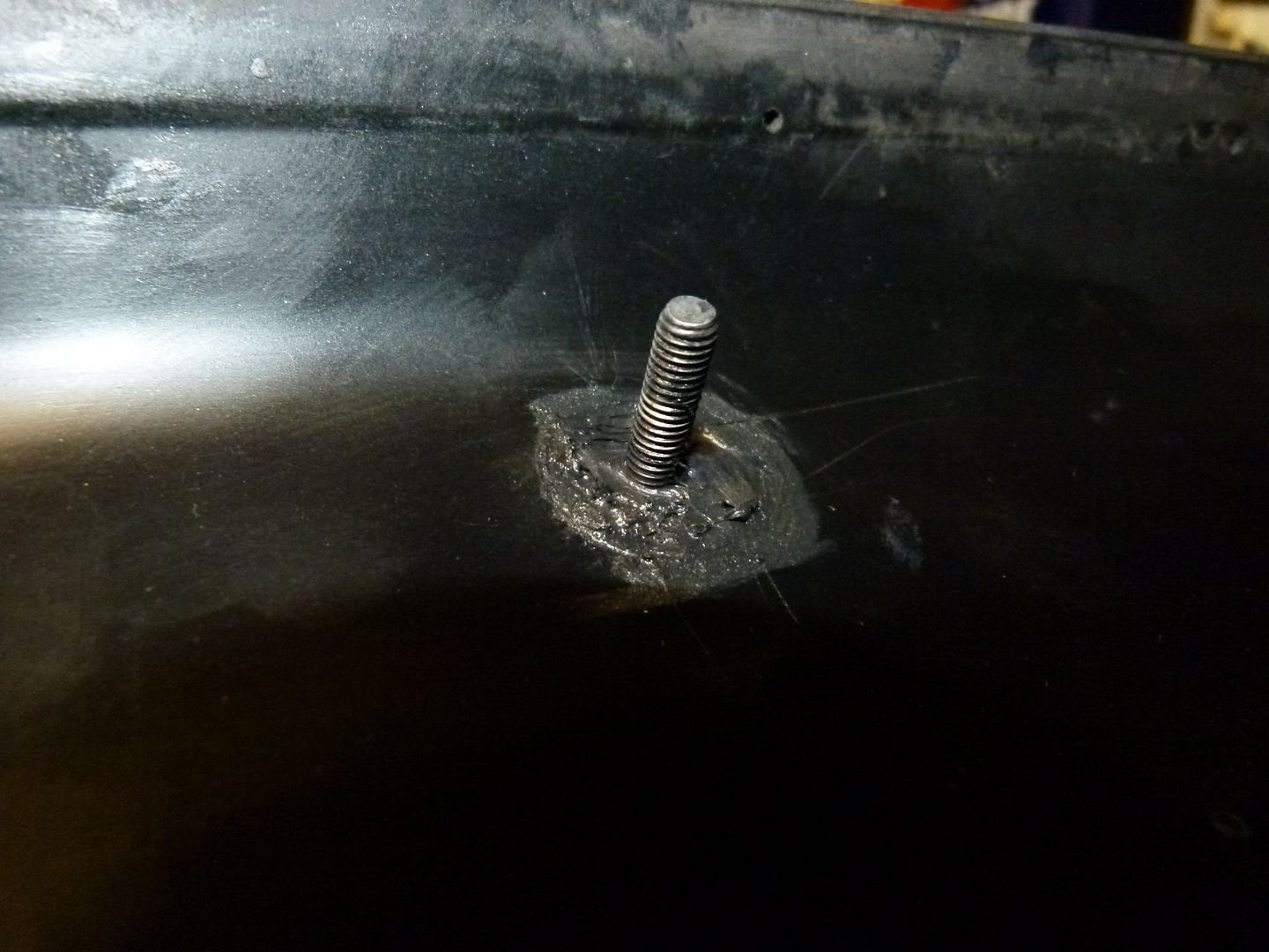

    Then I decided to treat it to a Mtech1 Rear spoiler which needed a bit of work:
    Removing the snapped bolt and making it right:
    Next I thought id try a bit of black silicon to patch up the crack:

    I finally sorted the eye sore in the engine bay which was my makeshift pipe! Turns out I bought the last one in the country 8)
    (Much better)
    Replaced it bled the system and gave the engine bay a good clean 8)

        dedication, nothing wrong with an engine pull in the snow
                Its true..If done right! These guys weren't serious! lol
