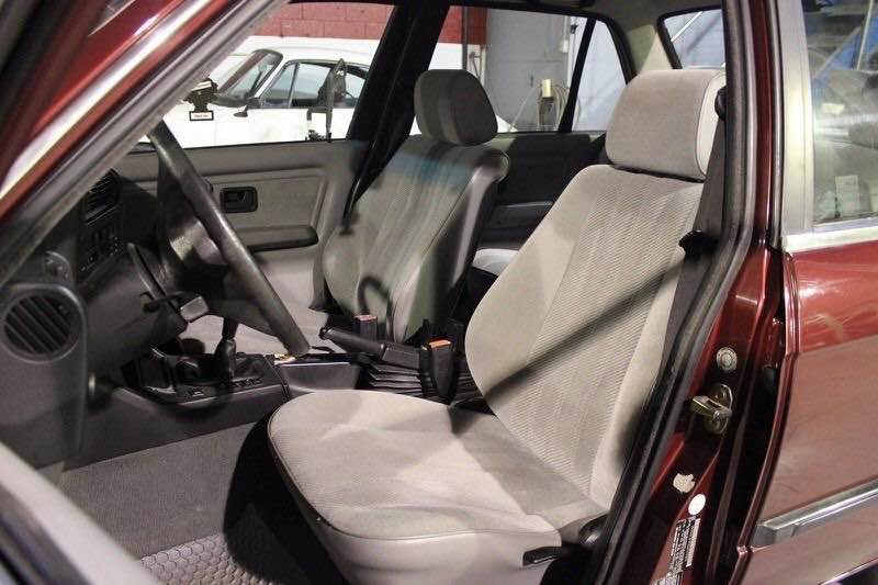

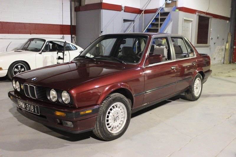

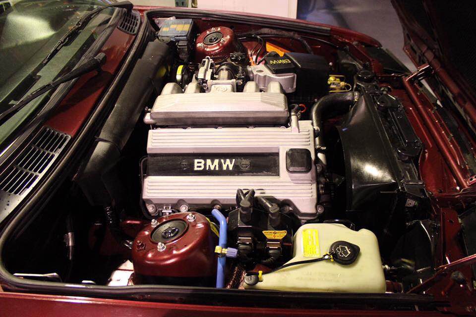

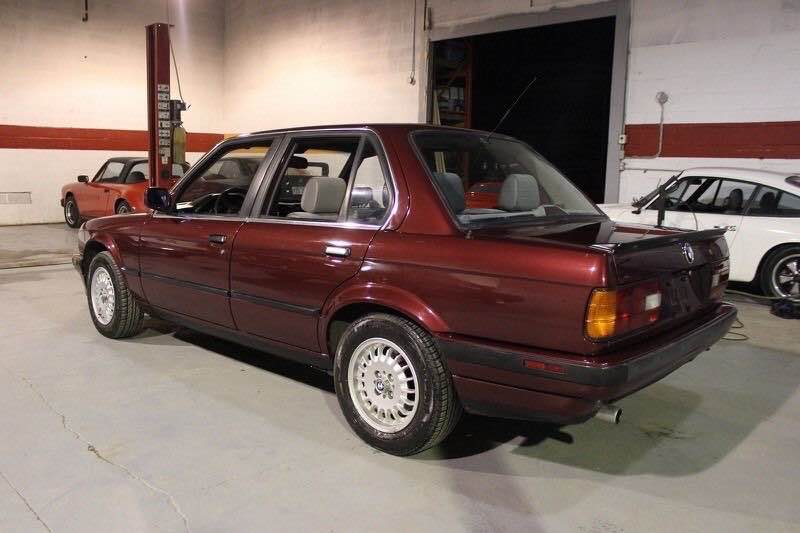

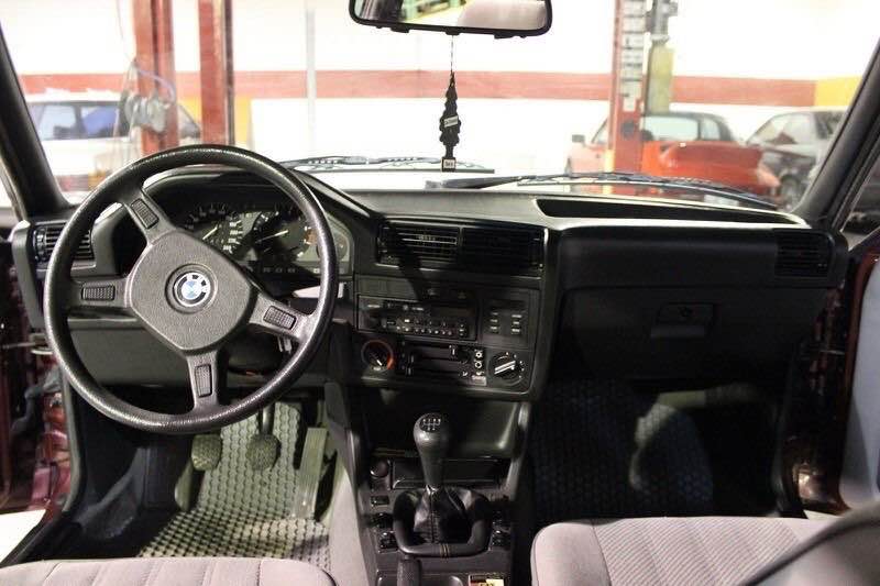

                  Thanks for all these answers! I didn't expect that much! So here is the car I'm planning to buy next week. (first time adding pictures on a thread, tell me if you can see them!). As you can see, it is in a showroom condition.
                  HTML Code:
                  Make sure the car you are considering is actually in mint condition. Unless it was a summer only car, I have serious doubts.
                  The car will be inspected by a BMW specialized mechanic in his local garage which really is 1 mile far from my house. When I will have big issues I won't be able to fix myself, I'll go ask for a little help!
                  HTML Code:
                  I would recommend you find a 5-speed E36 and learn on that. For  the same money as a beat-down E30, you'll be able to find an E36 in  decent shape. Try to get one with maintenance history, because older  BMWs can nickel and dime you with repairs. The E36 is a great car, and  anything from a 318i upto a 328i will be fun for you.
                  I did consider going for an e36 since they are cheaper here, but they seem to be real rust buckets. So, finding a clean rust free and bone stock manual e36 can be quite hard too. Also, keeping in mind I'm only 17, insurance would cost much more driving a 328i or a 325i than a 318i. Plus, I've been looking for an e30 over a year now and I just feel like I found the one that fits exactly what I was searching for, i.e. a 4 door manual late model 318i with the m42 with any paint but white, grey or bright red. I feel like not buying this car would be a wasted opportunity. And IMO, e30s just look so better than the e36, even if the e36 isn't that bad either!
                  • stonea
                    • 2892
                    The car looks pretty clean, but like everyone has been saying, that doesn't really mean it is clean. When you go get the PPI make sure the guy looks EVERY where for rust. Take off heat shields, pull back trunk liner and the carpet, and I'd even take off the trunk and hood gasket to check under there.
